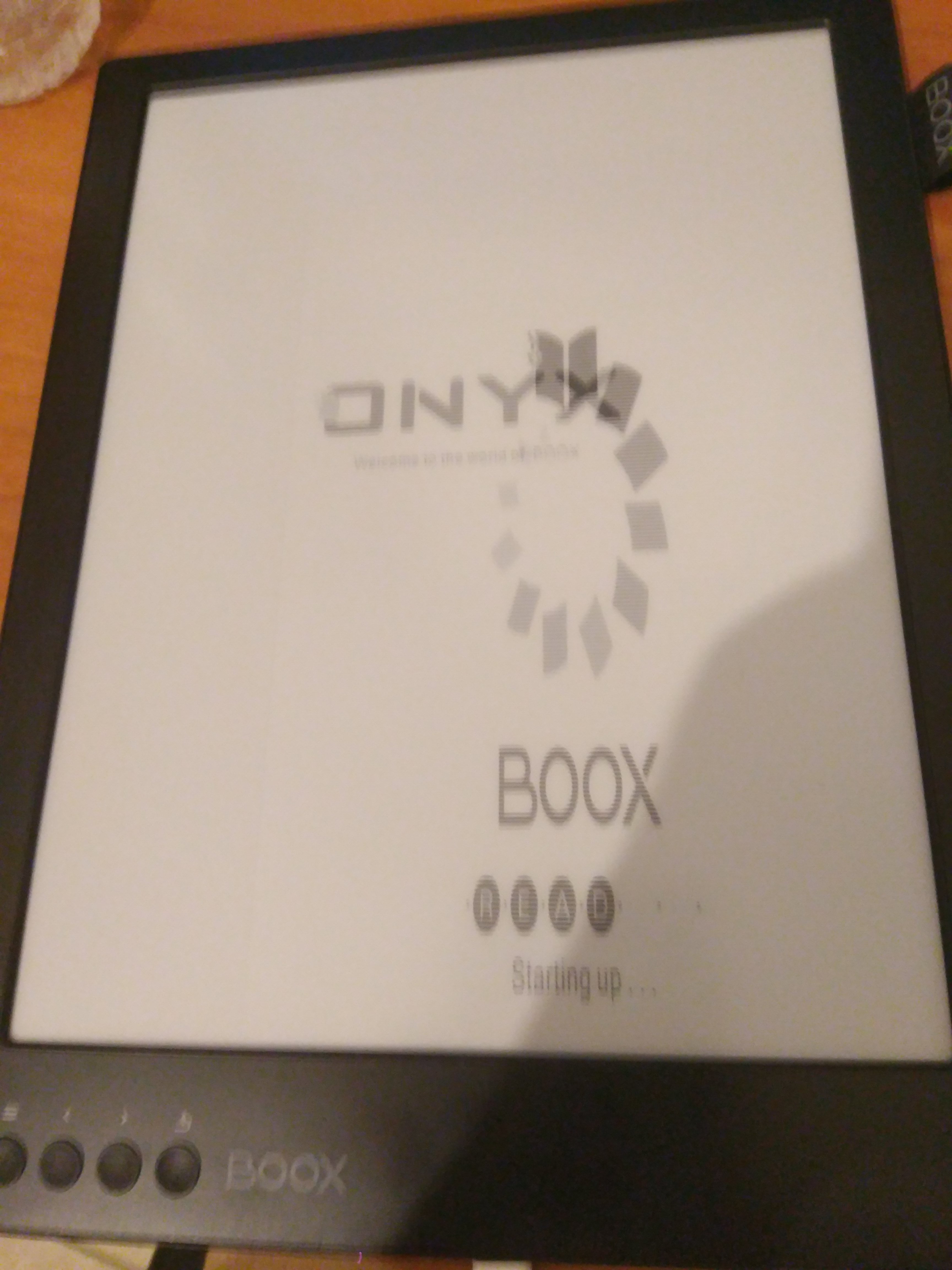

i tried to install firmware for this page http://ereader-store.de/en/content/8-downloads for the Onyx Max using the mfg pack for android 4.4 and now my device is unusable with a distorted display. tried reinstalling 4.0 by the other mfg tool but it stays the same.
How can i fix it?
Thanks

Isn't there any way to flash stock firmware?

You can flash the stock firmware by the Mfg tool pack. Did you download the correct firmware, e.g. MAX vs Max Carta?
Anyway did you solved the problem already? I guess so since your post was more than a week ago.

Thank you.
Yes i solved it , flashing the correct firmware was the key.
