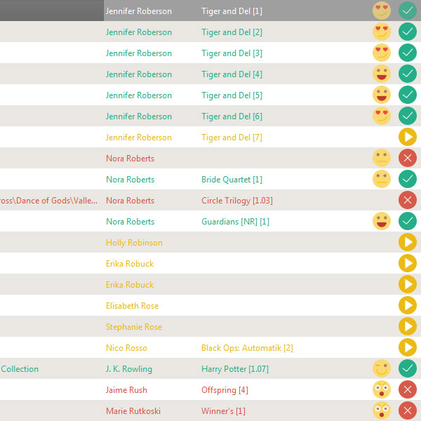

I'm having lag issues with custom icon rules.
I've added a dozen rules for custom icons. 5 icons for 1-5 star ratings. Then 7 icons for different shelf values. My library is around 18k books.
After adding the icon rules, there's a huge performance hit. Scrolling through the list of books is very very slow and thus laggy. I've tried using from 512x512 icons to 32x32 icons and it is still laggy. Regardless of icon pixels though, all the icons set total to 382kb, which isn't a lot.
I've tried deleting the rules and the lag is gone. I've tried the icon rules on a smaller library of ~1000 books and the lag is still there, albeit not as laggy but still lags.
So, just wondering if anyone has same problem and if there any tips to improve performance? Note: I don't think my computer (amd octocore and 16gb of ram with ssd) is that slow for adding 12 icons to the rules set, or is it?
Attached a pic of icon rules and it seems pretty simple and not a lot, which I don't understand why it will lag so much.

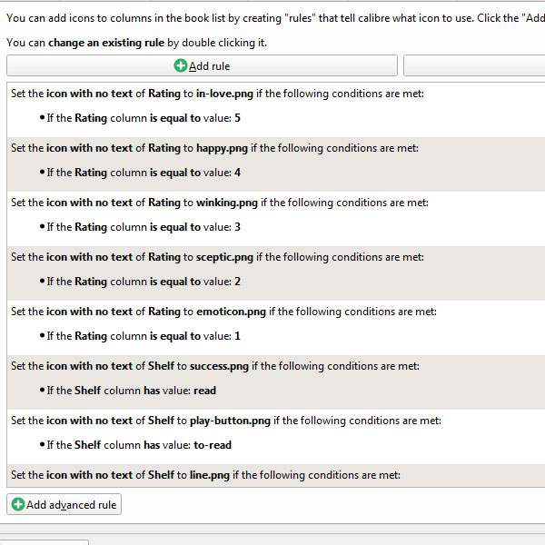

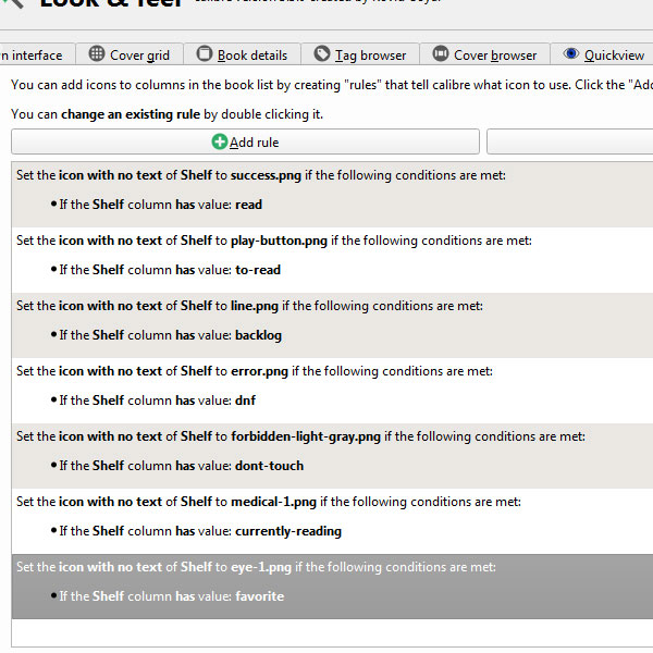

The columns are not composite; one column is the normal "rating" and the other is a custom "#shelf" with direct values. I don't know how to use advanced rule since I don't know how to do programming language. Just a regular smoe joe.
I've changed all the icons to 128x128 pngs but it didn't make a difference.
Thanks for the help.
Attached is the rules wizard for the icon rules for the ones that are shown.
ID:	157832   Click image for larger version

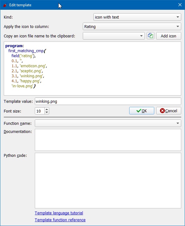

You can improve the performance of the two basic tests by using an advanced rule. Here is an example for Rating, replacing all 5 current rules.
The text in that box is:
program:
	first_matching_cmp(
		field('rating'),
		0.1, '',
		1.1, 'emoticon.png',
		2.1, 'sceptic.png',
		3.1, 'winking.png',
		4.1, 'happy.png',
		'in-love.png')
It works by comparing (rating < value) where value is 0.1, 1.1, etc, returning the string (file name) if the comparison succeeds. As such, the first comparison succeeds if rating is 0 (less than 0.1), and so on.

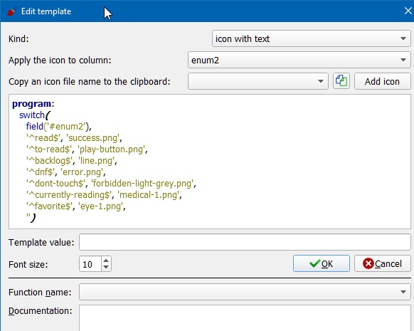

Assuming that #shelf is a text-type (perhaps with a fixed set of values) then this advanced rule should work.
Here is the text shown in the dialog
program:
	switch(
		field('#enum2'),
		'^read$', 'success.png',
		'^to-read$', 'play-button.png',
		'^backlog$', 'line.png',
		'^dnf$', 'error.png',
		'^dont-touch$', 'forbidden-light-grey.png',
		'^currently-reading$', 'medical-1.png',
		'^favorite$', 'eye-1.png',
The search fields (read, to-read, etc) are regular expressions, which is why they are anchored (begin with ^ and end with $).
I used #enum2 because I don't have a column named #shelf.
