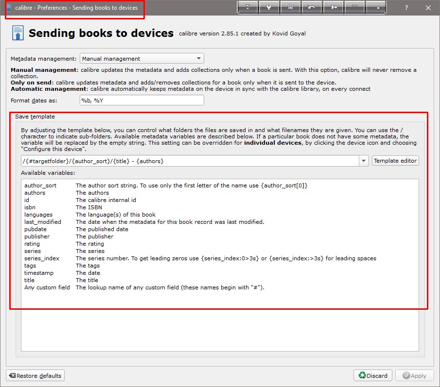

When you send a book to a device or save it to disk the output directory and file names are specified by a template in the relevant preference settings, viz:
It would appear that you've lost some of the template you had - make sure you check the device configuration template, it overrides the one in Send To Device preferences.
Attachment 157758
I just looked in Calibre, and what you posted is what I see.
