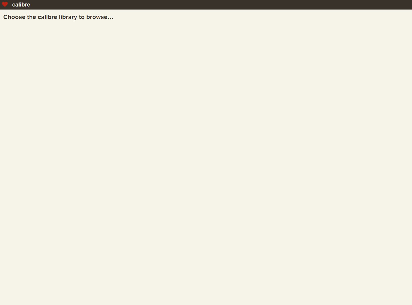

I ran calibre server with bellow command
calibre-server --port 8082 --auth-mode basic --enable-auth --userdb /opt/calibre/pass --daemonize --log /var/log/calibre3.log /mnt/eBooks/
I disabled auth as i do not know if statement --enable-auth --userdb /opt/calibre/pass is correct and in what form should the pass file be and now I get an empty library
and tried for testing with calibre-server --port 8082 /mnt/eBooks/
When I open calibre from windows, GUI is loaded with all my books but content library again is empty
can you please help?

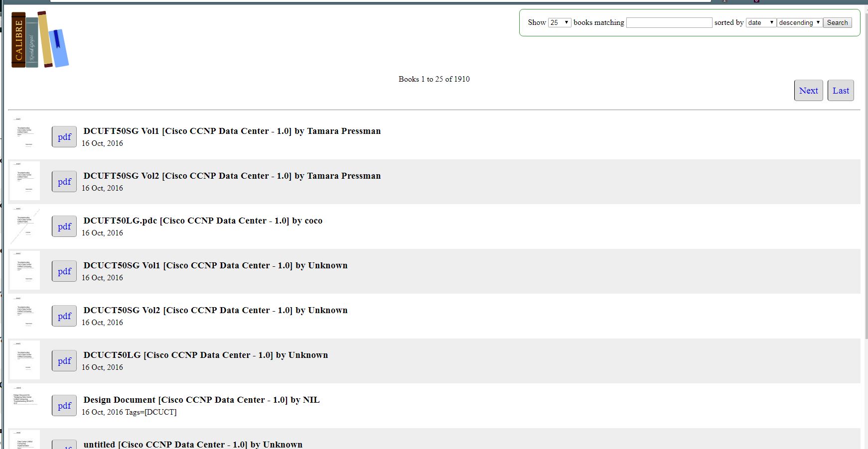

tried mobile site and it is wokring
http://192.168.100.6:8082/mobile
So what is wrong with full site??
Tried with Google chrome, Firefox and exlorer 11

If you want to use --userdb you first need to use --manage-users to setup the user accounts. Line this
calibre-server --userdb /tmp/calibre-users.sqlite --manage-users
create the user account
then run
calibre-server --userdb /same/path/as/before --enable-auth /path/to/calibre/library/folder
/tmp/calibre-users.sqlite must not exist when you run --manage-users, it will create it for you. Change it to whatever path you actually want to use.
As for the libraries not being listed in windows it is most likely because you have your calibre library in the root of a drive. This will be fixed in the next release.
