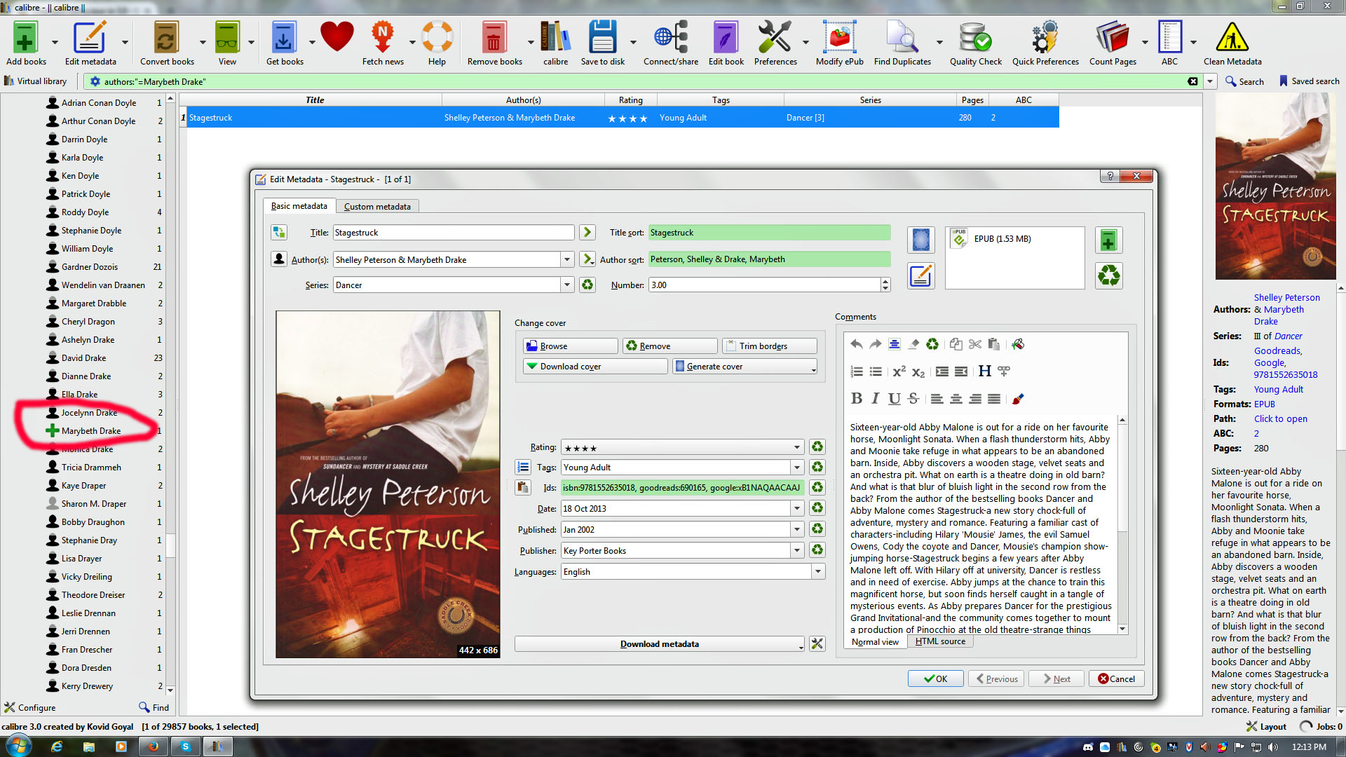

Device: Samsung Galaxy Tabs
I also have the same problem. If you delete an author, for instance Heinlein, the older Calibre versions would center themselves at the location on the tag browser list where Heinlein was. The 3.0 version now goes to the top of the H list.
Also, like the OP says, if you change a misspelled author name the browser again goes to the top of the list instead of staying where it was at.
I've started having a second author open ( ctrl new author name next to author that I want to change) at the same time when deleting or changing a name so that I won't bounce back to the top of the author list.

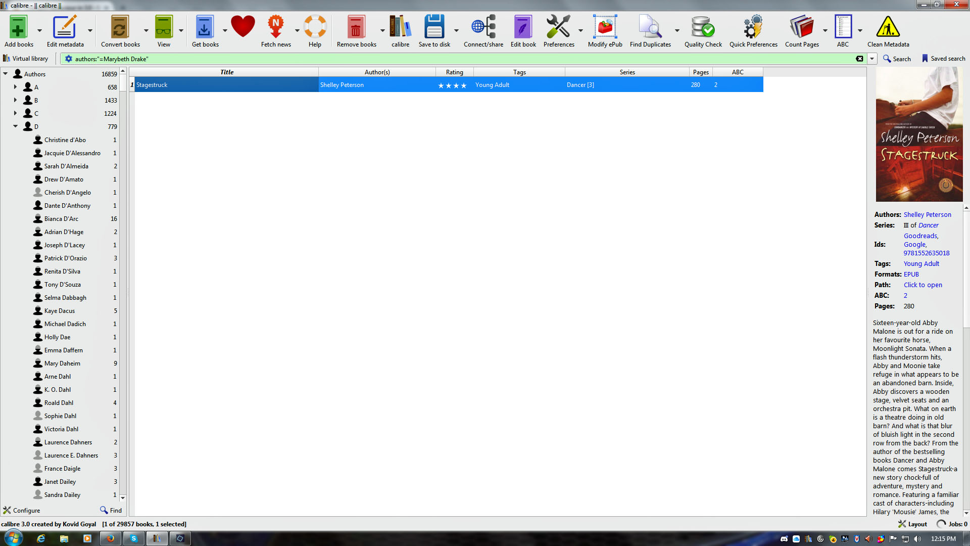

Ok, in this example I have removed an incorrect author from a book. In the old world the list on the left STAYS CENTERED and I know exactly where I am up to.
Since Updating to 3.0 it bounces back to the beginning of the list and I have to try to figure out where I was at, every single time. There are no words for how frustrating this is!

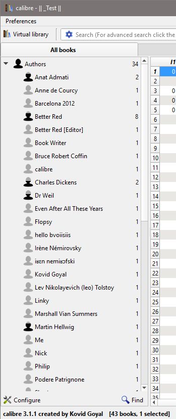

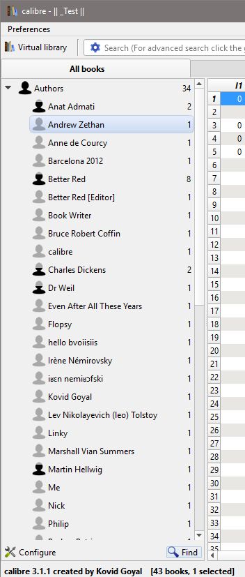

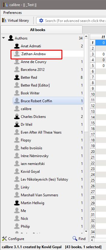

Old 06-26-2017, 01:03 AM   #14
Posts: 22,394
Karma: 31000056
@Trevor68 - how are finding mis-identified books, by looking at the book list or at the tag browser?
If it's the book list, when you spot book tagged as 'Cimean War' and you know it should be 'Crimean War', hit F2 on the tags cell for that book and change it right there, the change will be applied to all books tagged with 'Cimean War'. Then you won't even need to look at the Tag Browser.
@Kovid - it doesn't put the renamed author centre view for me
First image shows starting point with author 'Andrew Zethan', second image shows me changing it to 'Zethan Andrew', third image is what I see after I press Enter. I have to scroll down to see 'Zethan Andrew'

Old 06-26-2017, 11:45 AM   #15
Turtle91
A Hairy Wizard
Turtle91's Avatar
Posts: 3,462
Karma: 20534347
Join Date: Dec 2012
It looks like you are sorting by author (First Last) and then when you change the author name it puts it in proper alphabetic order with a "Z" at the end. If you are saying that you want the "Z" name to stay right where you are looking in the list then you would need to turn off the sort function...but I'm not sure you can. Best case would be to sort on something other than the author name...then changing the author's name won't change the sort order.
If that makes sense...
