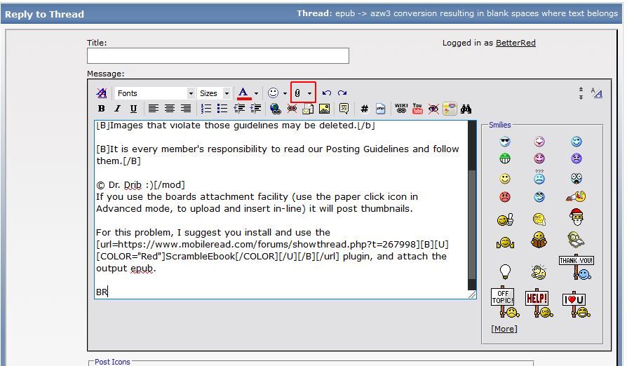

If you use the boards attachment facility (use the paper click icon in Advanced mode, to upload and insert in-line) it will post thumbnails. See my attachment.
Rather than posting code fragments you could install and use the ScrambleEbook plugin, and attach its output epub.
