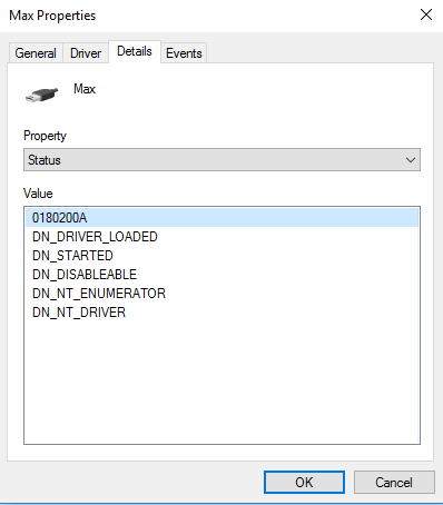

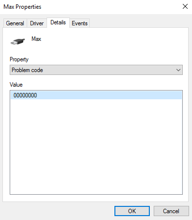

The following advanced properties may be useful to troubleshot your case if you still have any problem even when using the MS driver:
Good luck!
