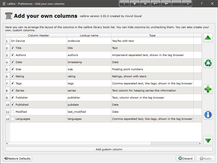

@Margot1975 - Are you trying to add a new Custom Column, or show an existing column.
The following shows the default setup, perhaps you could 'talk' to it:
