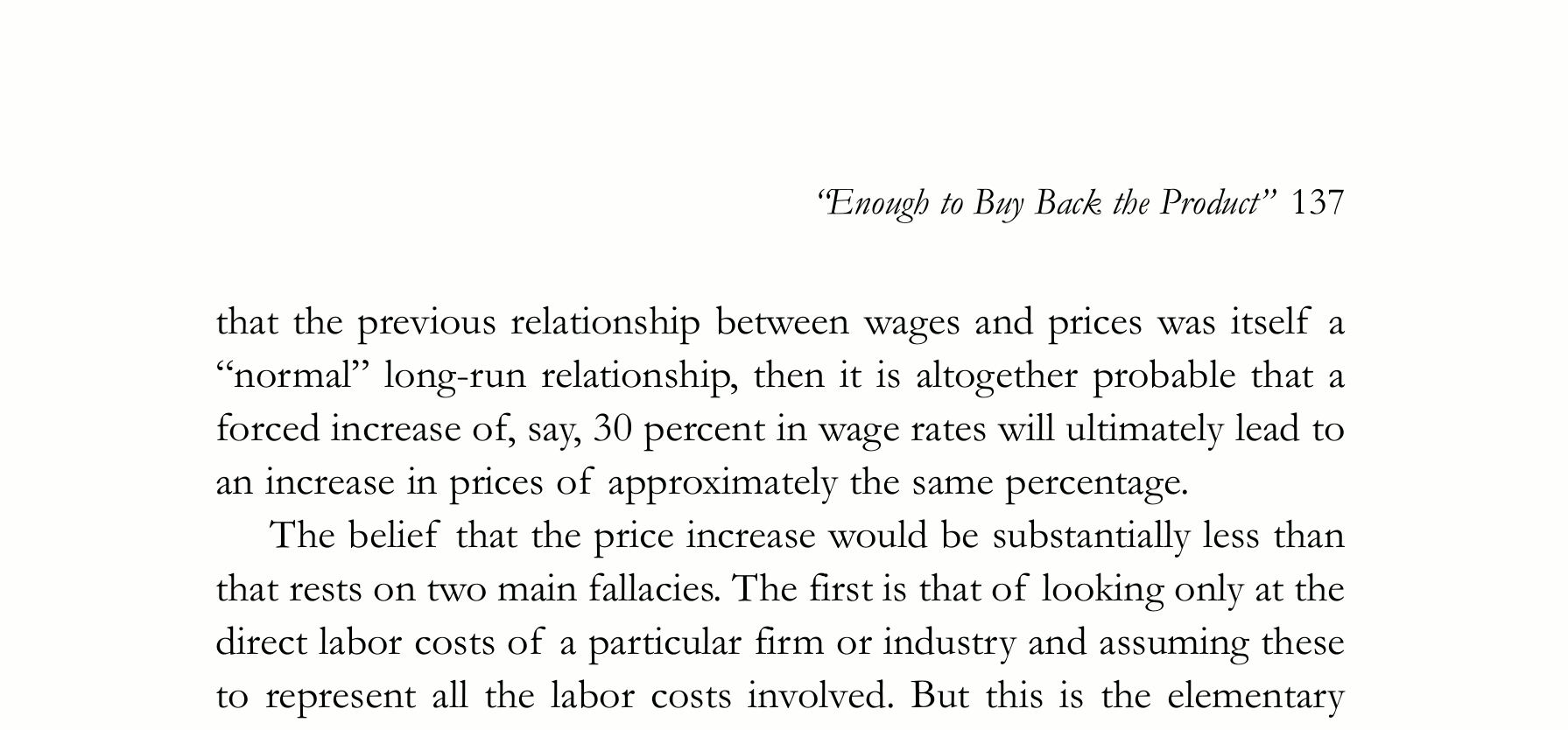

I find Finereader does a pretty decent job at detecting the Headers/Footers and never exporting them to the output format in the first place. There is the occasional book it has problems with (mostly when the Header/Footer is extremely close to the text block), but 95+% of the books it works nearly perfect.
See how close the Header is in Figure A:
Finereader has a serious problem with detecting the Header in that book... you can see how it could easily be seen as a part of the body text.

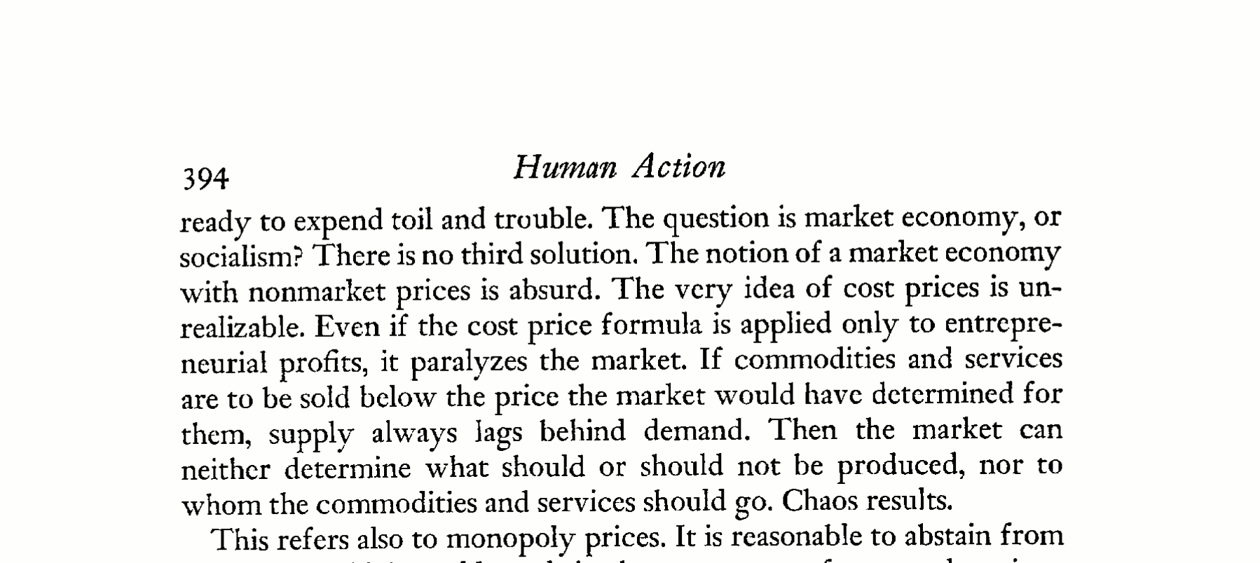

And see what your typical book in Figure B:
Finereader has absolutely zero problems with that. Only when the Header is as close or closer than Figure A might Finereader start to become inaccurate with its guesses (maybe it will handle the Headers perfectly though.... each book is different).

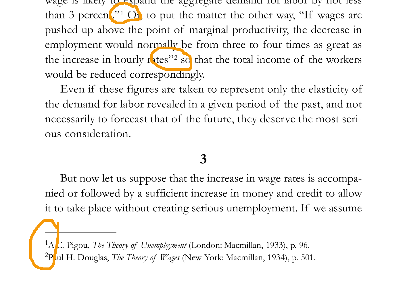

Originally Posted by fcemari View Post
2. The reference numbers in superscript at the end of sentences have to be manually linked. Is there a way to do it automatically?
No.
Depending on the export format, Finereader does try to do its best, but it botches the "linking back/forth footnotes" pretty badly. The only way to handle it is properly is to manually correct them.
There are some tools to kind of help speed up the process though:
1. If you have Microsoft Word, you can use Finereader to export to DOCX (Formatted), and then run Toxaris's EPUB Tools add-in (doesn't work in the Mac version):
https://toxaris.nl/en/
Toxaris specialized his tool for a lot of Finereader cleanup (and a ton of of other helpful things). If you use his tool and press "Preparation", it can clean up a lot of the Finereader DOCX cruft. You can then fix the document in Word, or export from there and do more thorough cleaning.
2. Taking the HTML and doing lots of fancy Regex (each book is different).
Some generic rules can apply though, like searching a book for all <sup>##</sup> (these are most likely superscript footnotes sitting in the text). Or searching for paragraphs starting with a superscript number (this is most likely a footnote):
Things can get a little hairier if you have a complex book (like one with formulas) or OCR errors (maybe a ” [Right Double Quote] might be OCRed as a <sup>9</sup> or a ° [degree] might be OCRed as <sup>0</sup>).
3. Footnotes at the end of every page should be either deselected or manually transferred to the end of the pages in order not to compromise the book's reading in epub format. Is there any automatic solution for that?
No.
You will most likely have to manually fix/check the links and place them in the proper order/location.
Side Note: You will also have to keep an eye out for footnotes that are missing text or large footnotes that carry on to a second/third page... these will have to be manually stitched back together.
