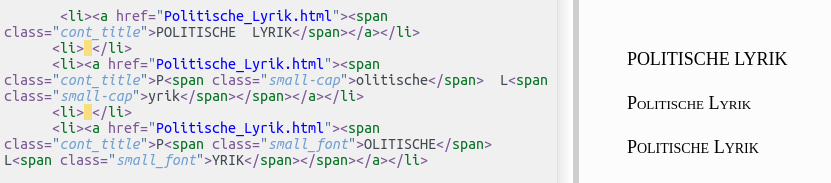

I got currently an problem with SMALL CAPS: They don't function in my ereader (built 2015/16, so I assume in other ereaders is the same) - CSS font-size does. In calibre File Preview they function both.
Name:	SMALL CAPS vs font-size: 0.75em;.png
span.small_font {font-size: 75%;}
75% (or 0.75em) works fine with the surrounding characters (in ereader). But it's not exactly SMALL CAPS.
What do you think about!?
If you're referring to:
 font-variant: small-caps;
it's indeed rarely supported by eInk rendering engines.
In addition to your solution some ebook designers embed a special small caps only font.

You would be better off by embedding a small caps font like Doitsu said. That is the only way to get real small caps.

But you would also need to embed the main font to be sure you got the correct small cap and the correct main font. Also, it depends on how often the small caps is used as to whether fonts should be used or the fake small caps should be used.

span.small_font {font-variant-caps: small-caps;}
Warning: CSS Property: Unknown Property name
Fonts are Dejavu or Times New Roman: they are already in calibre. Or not?

You have to either have a license to be able to embed the fonts or they have to be public domain or be released under a license like the SIL license.
Now the problem you'll have is if you sell via Amazon, Mobi eBooks do not support embedded fonts and KF8/KFX eBooks default to not showing embedded fonts.
Yes, that was my CSS before (not functioning in ereader).
If I understand right: The small caps font and the main font should be the same font family. Of course! I don't will use any different, 'only a little bit similar' looking fonts.
Probably you mean: Is it worse to buy a related small caps and main font, if using only one? time. Of course not. It's a book for private use only. Not must be 100% correct.

After all said above: Is it recommendable for me to continue with 'fake' small caps via
span.small_font {
  font-size: 75%;

Yes, if you don't have too many instances of small caps and the fake small caps won't be a bother then go ahead and use the fake small caps.

Thanks! I use them only as a distinctive feature for some headings (to look like old style and original).
