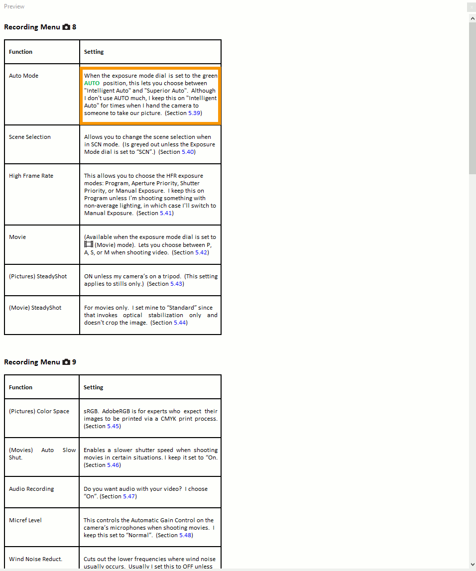

Next I want to enlarge all images that appear within tables / figures:
Find: <table width="100%">((.|\n)*?)src=(.*?)class=(.*)/>(.*?)Figure((.|\n)*?)/table>
Replace with: <table width="100%"> \1 src= \3 width="100%"/> \5 Figure \6/table>
This works for most but not all images within figures. The red arrows in the upper-right-hand corner of http://friedmanarchives.com/~downloa...escription.jpg shows examples of where it fails.

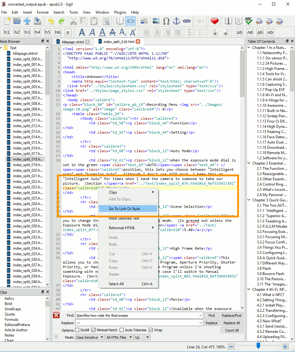

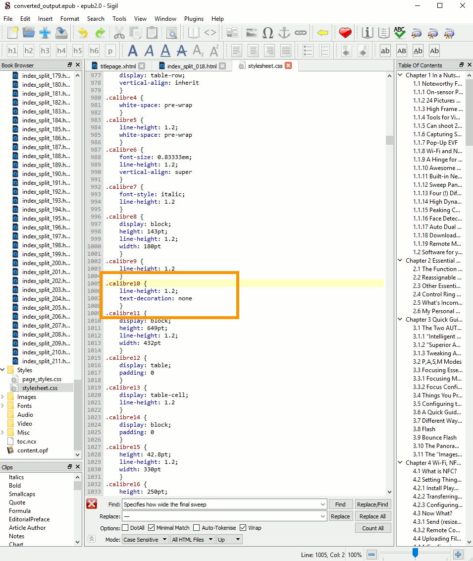

Hmm, I will have to take a look again at the source file.
IF Word Styles were used properly throughout, to my knowledge, Calibre would have drastically cut down on the 1300+ "calibre##" + "block_##" classes, and instead had many classes named "MsoNormal" + "MsoNormalTable" + Word's naming conventions (you can see a lot of the Word classes if you do a Word -> Save As -> Filtered HTML).
You may have accidentally introduced some Direct Formatting somewhere along the line (WYSYWIG Editors are pretty crappy at introducing hidden cruft).
Originally Posted by Gary Friedman View Post
Plus you said "Once you throw in a Calibre conversion all bets are off." Not sure how I should interpret that. Do you mean it's hopeless?
Heh... no... I meant it like this.
Code from your specific DOCX -> EPUB conversion:

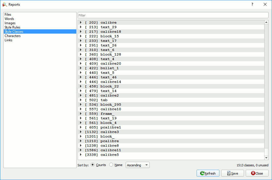

If you are going to be cleaning up/editing the EPUB, you should at least know basic HTML+CSS.
I find the Calibre/Sigil Reports functionality is very helpful in spotting all the different classes:
  • Calibre: Tools -> Reports -> Style Classes
  • Sigil: Tools -> Reports... -> Style Classes in HTML Files

And then there really is nothing that can replace just going through the entire book with multiple passes, figuring out what each class is doing, and "fixing" it:
ID:	154502 Click image for larger version
And in Sigil, I much prefer right clicking on a class and pressing "Go To Link Or Style". This jumps you directly to the CSS class:
So in that case, calibre10 is useless, so you can get rid of all references in the EPUB.
As you can see, there is an absolute TON of cruft introduced... so depending on the book, different workflows might be faster (maybe Calibre might be best, maybe Word Filtered HTML, maybe BetterRed's recommendation of Mammoth, [...]).
