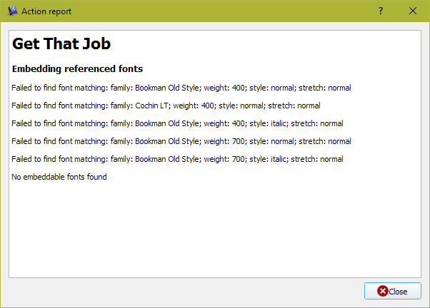

Calibre will only embed certain fonts and not others. Why?
Often I get this error message:
Failed to find font matching: ...
See attached image.
How come?
How do I know which font it will embed, and which it wont?

are those variations installed on your system?
Do they allow embedding (in the fonts properties)?

There are many possible problems in font files that can prevent them from being matched. Impossible to say what the problem is with your particular fonts without access to the font files.

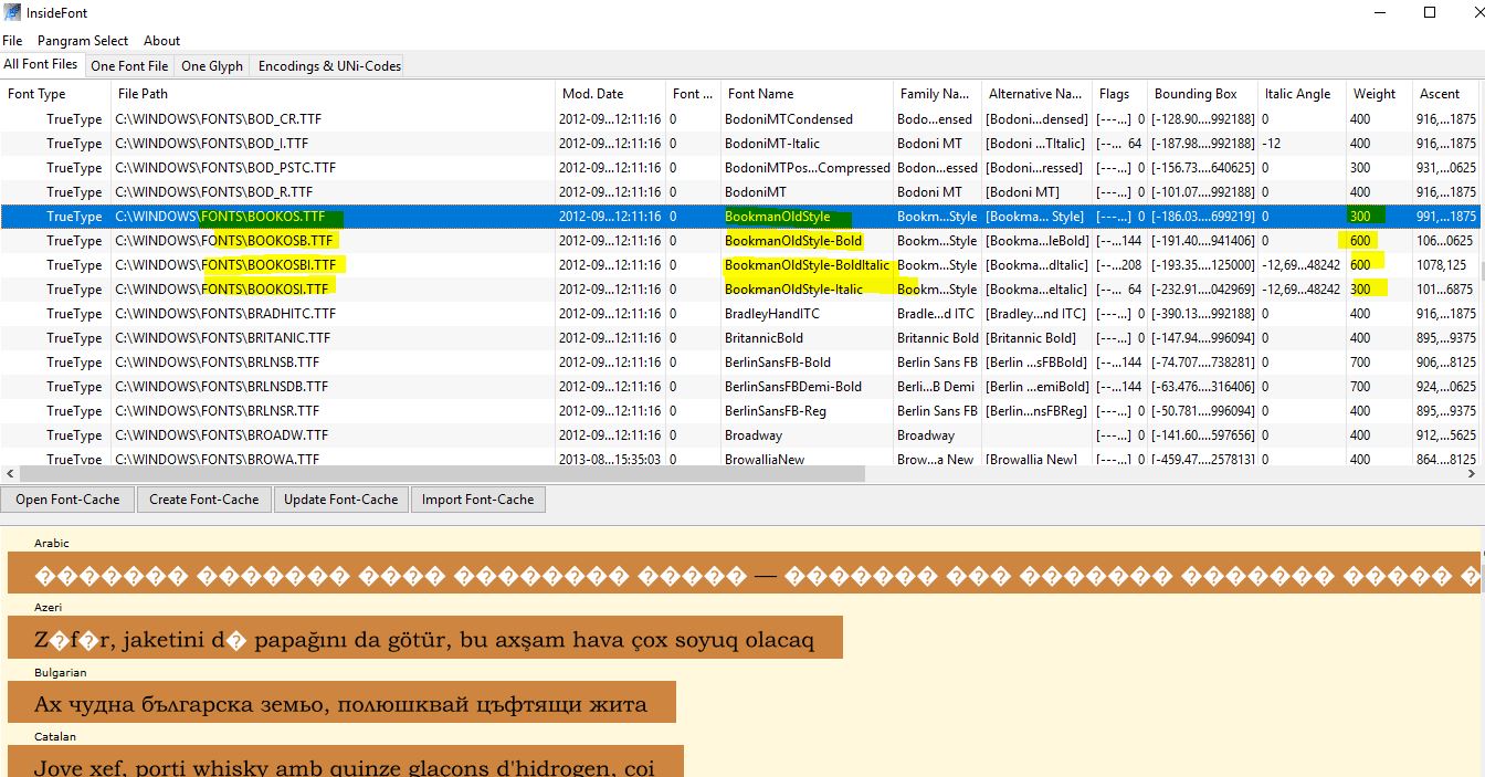

Maybe he is looking for the wrong weight 400 and 700? Bookman old is part of MS Office, but weight there is 300 and 600

It's a nice tool called Inside Fonts (http://www.insidefont.de/en/index.html).

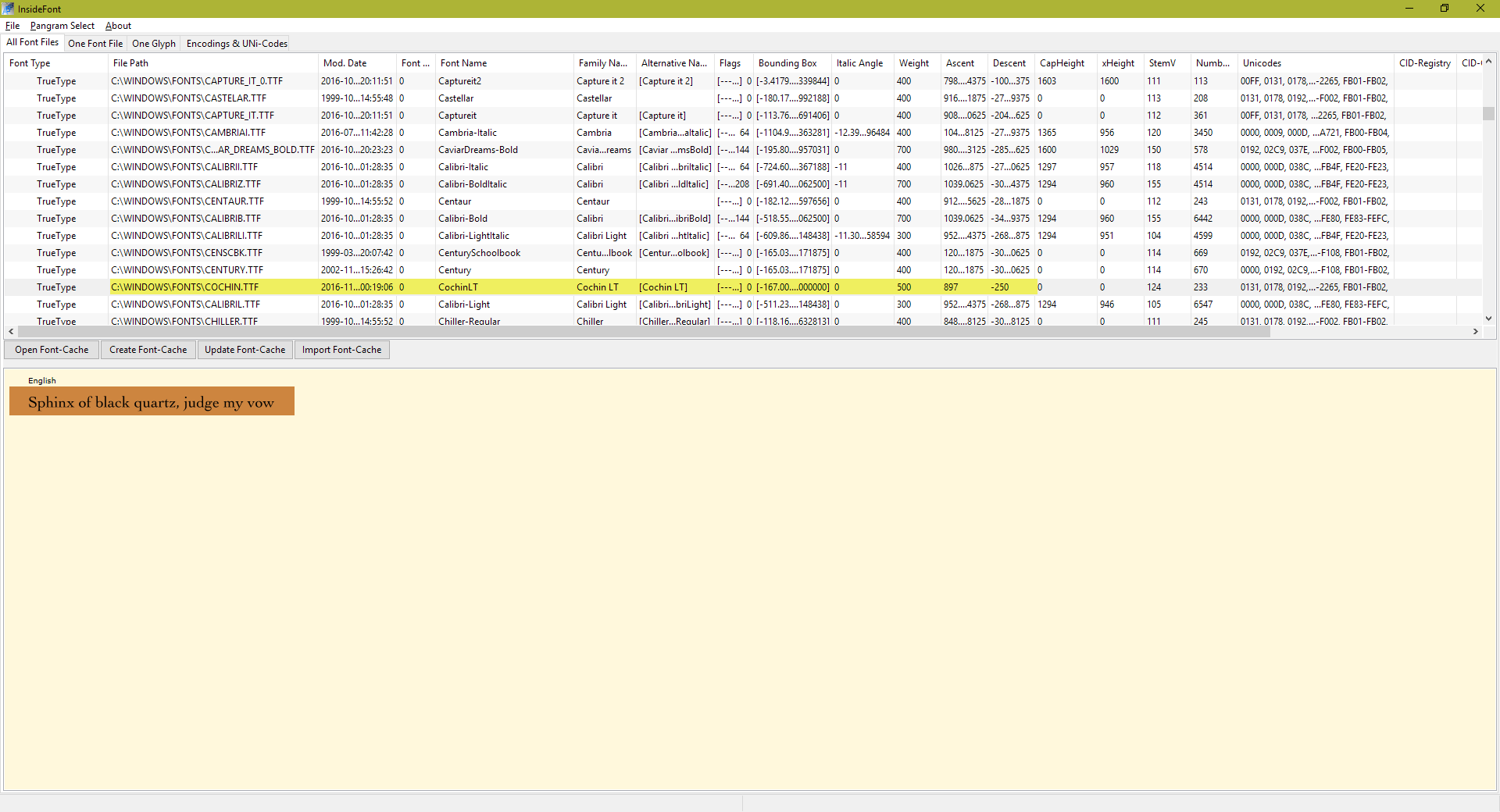

I only included one font.
One thing I will also bring up, is whenever I embed fonts during a conversion, whenever I open the file in the editor, and click the check for bugs button, it gives me this error for every font that's successfully embedded:
CSS: Property: Not valid for profile "['CSS Fonts Module Level 3 @font-face properties']" but valid "CSS Fonts Module Level 3" value: normal [9:5: font-stretch] [page_styles.css]
If I upload to the IDPF validator, the epub validates whether I remove that from the CSS or not. But Calibre throws up that error every time a font is embedded.

Since this program told me that the Cochin font I like is on my system in 500 weight, I edited the code in stylesheet.css.
I changed
font-weight: normal
to
font-weight: 500
Looking towards a solution to this, please forgive me for reiterating: I did not initially specify a font weight. All I did was convert a Word docx file to epub. The only check boxes of consequence that I have checked in the conversion process are Embed all fonts in document and Subset all fonts in document.
Based on the error messages I've gotten, I am guessing most programs understand font-weight: normal to = 400.
Is that the spec?
Yes it is:
Per: https://www.w3.org/wiki/CSS/Properties/font-weight
The keyword 'normal' is synonymous with '400', and 'bold' is synonymous with '700'.
