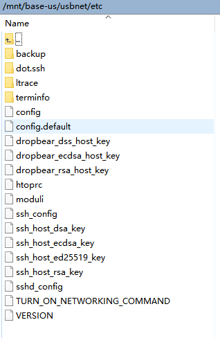

the config file in the kindle shows SSH over wifi is disabled (the introductory texts have been deleted):
KINDLE_IP=192.168.15.244
USE_WIFI="false"
USE_WIFI_SSHD_ONLY="false"
USE_OPENSSH="false"
QUIET_DROPBEAR="false"
TWEAK_MAC_ADDRESS="false"

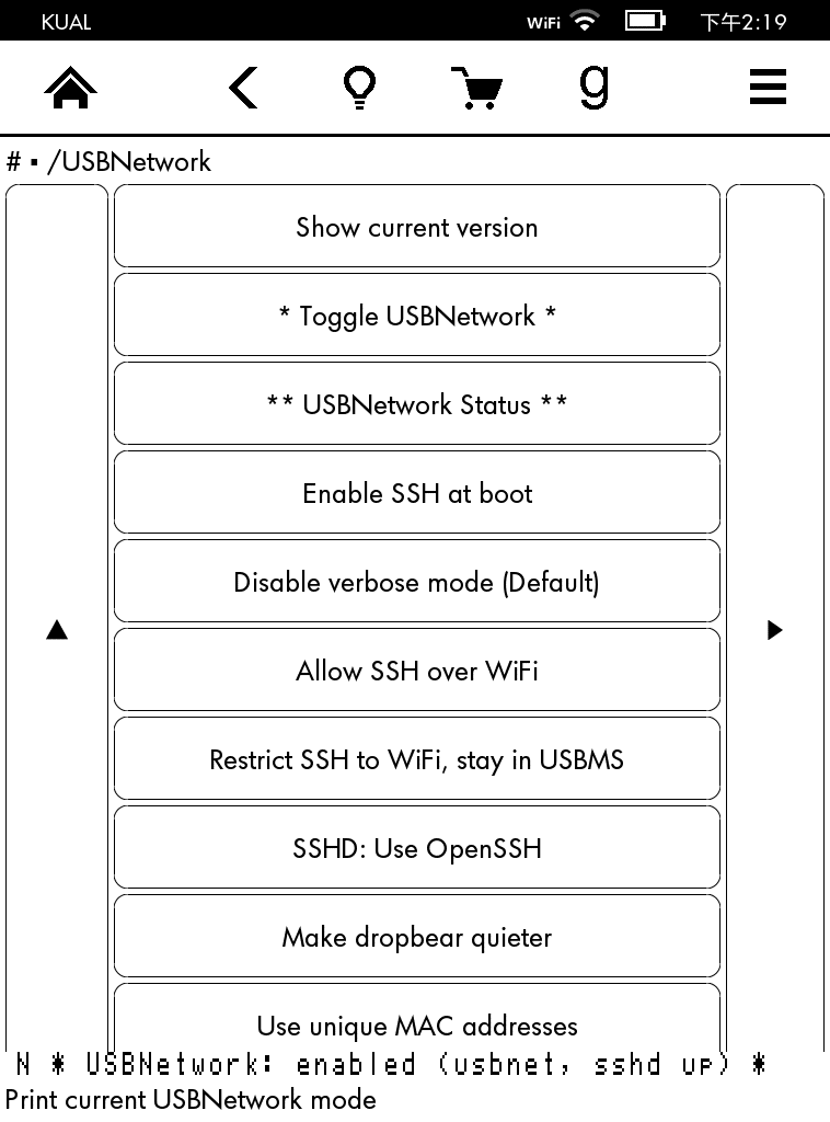

And in the attachments: there's the screenshot with the text showing up after I toggle usbnet on, and another one is the usbnet/etc directory files with these I-don't-know-what-it-means files. Maybe they'll give some information.

when you toggle down usbnet, what message you get if you show usbnet status?

When I press the toggle button (to stop USBNet):
N switching from usbnet to usbms
N stopping sshd
The last line of the code doesn't seem to stop. Then I press the show status button:
N * USBNetwork: disabled (usbms, sshd down) *

Delete the /usbnet directory and sub-tree.
Delete the /extensions/usbnet directory and subtree.
Copy the most recent version of USBnet from NiLuJe's snapshot thread into /mrpackages.
Be certain to use the file with you device's nickname in its filename.
Exit from your ssh (or scp or sftp or whatever you used) session.
Now trigger MrPI to install the most recent version.
None of the above should make any difference to kTerm.
You may want to use kTerm rather than an ssh session (although, because of the way the Linux filesystem layer works, you should be able to delete code that you are executing at the time).
Sadly, after updating USBNet and jailbreak, my kindle still fails to connect to computer via USB. Anyway, thanks for your help. Maybe it's really a kind of hardware problem, although I am cautious with connecting the cable to the micro-USB port.
