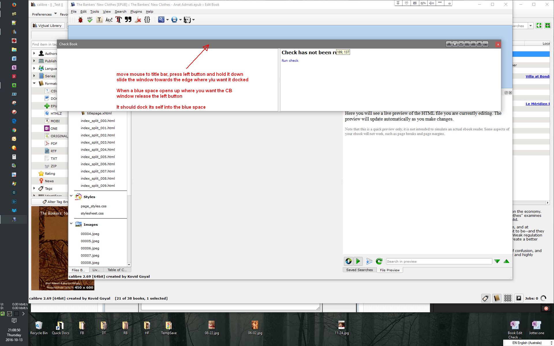

Was playing with the "View" commands, and turned off "Check Book".
When I turned it back on, it no longer docks, but sits at the top of the screen over the other windows so that I can no longer see the top of the document for example. Even the scroll bar at the far right is covered.
I've tried deleting all the "View" items then re-starting them again in various orders, but nothing seems to make the "Check Book" dock properly.
I'm guessing a re-install might/should cure the issue, but I thought it worth mentioning.

Reinstall wont 'fix' it. You need to redock the window, its simple once you've done it a few times - see if this helps:-

Seems I can't give you more KarmaPerfect answer for me. Man thanks. It is much appreciated.
