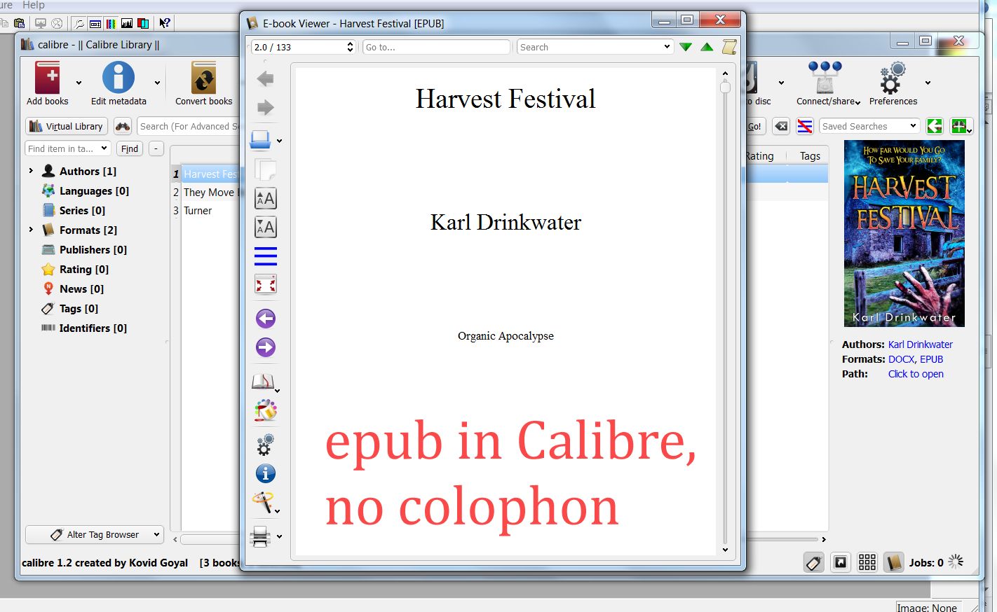

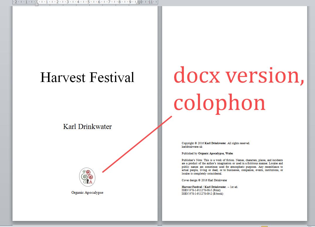

I was converting from docx to epub. But for some reason one of the images (the publisher colophon) is disappearing after conversion.
I use the standard epub options, apart from adding the cover and metadata, and ticking epub “Preserve cover aspect ratio”.
In the Word docx it is a png file (I was told they're best for ebooks - but I get the same issue if I switch to jpg).
Strangely - another of my files has a number of png images, and Calibre converts them all into the epub with no problems, apart from this one image at the start of the book, which it ignores. There are no error messages.

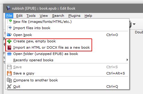

you need an empty book - start the editor from where its installed eg program files\calibre2\ebook_edit.exe, then File->Import HTML....

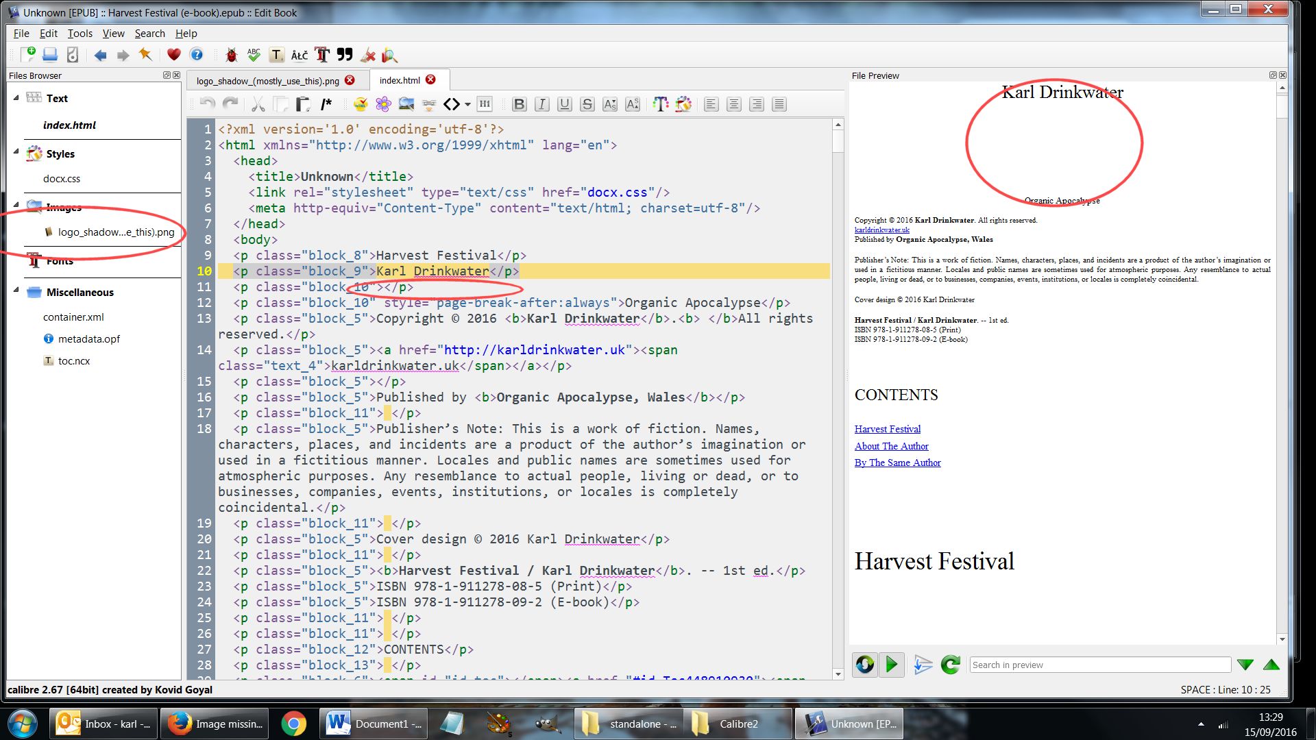

Ah. I just did that - same issue. Even though the image shows up in the list of files on the left, it is blank and doesn't show up in the preview on the right. (Image attached).
