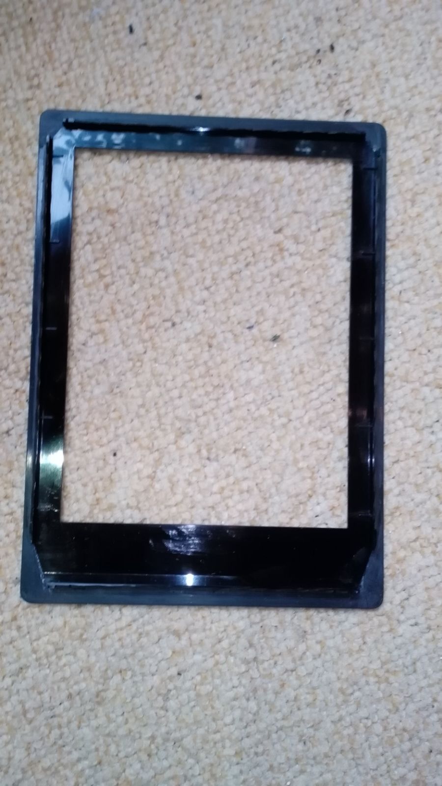

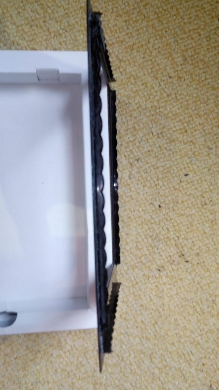

This is how my H2O bezel looks like, after cleaning and scrubbing.
Quite different.

You can see in your first picture... the bezel is made of two different plastics (one transluscent the other not), and the OP took those apart. I didn't know this was possible, it's normal for it to stay together in one piece.

Aha, I see. Seems like two different frames are glued together into one piece. One just for looks, the other for the IR transmitting and receiving. Curious how surquizu did take these apart?
