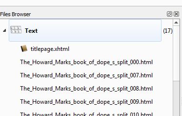

Hmm, is there a method to batch insert <titlepage>/cover as the first TOC index, or will I have to manually edit xxx number books ?.

You will probably have to edit the books. Using calibre's Polish Books will add the cover page, but it doesn't add it to the ToC. But, you can then use ToC editor from the main calibre interface without opening the full editor.

I have all covers installed as titlepage, I was hoping for an easy way to batch create the TOC entry, *sigh*, guess I'll have manually edit each book. What's 650x2min ? :-)
