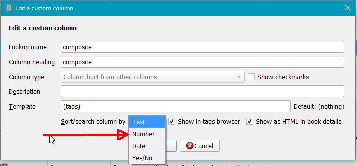

3) Is it possible to sort such a calculated column in an ascending/descending order like a regular numerical column, and if so, how to achieve that? At the moment, sorting is kind of alphabetical, based on the first digit, then the second digit etc. while ignoring the order of magnitude, i.e. 40 and 400 would be between 4 and 5.
Change the "Sort/search column by" value for the column to "Number". See the attached screen capture.

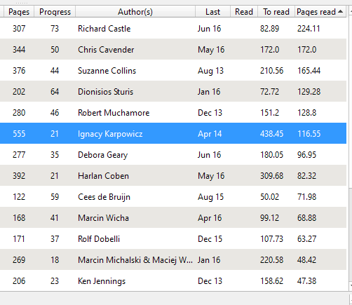

There is also some problem with sorting: I've chosen sorting by numbers in the column dialog but now when I try to sort, nothing seems to happen.
Now this is a mystery. It works fine for me. See the attached screen capture. The column "#myint" is what I used for "#pages" and "#myint2" is "#progress".

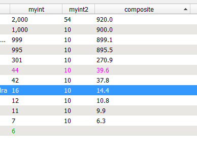

I'm pretty sure the sorting doesn't work, though. Are you absolutely sure it works for you? Based on the screenshot, it looks like it certainly does but theoretically, you could have sorted on myint first, by coincidence, and then the order would not have had to change.
Nope, that isn't it. I sorted by author then the composite column (column built from other columns) and it works fine.
Be sure that you are running the latest calibre. There were some problems with sorting in the mid calibre 2 releases.

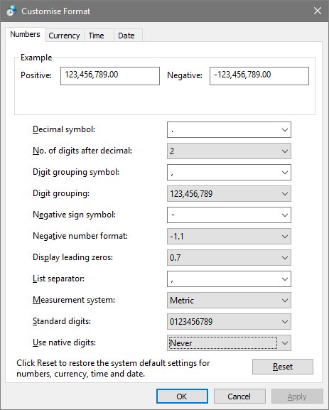

I have your metadata.db and ... it works fine. See the screen captures.
I don't have any plugins installed. Given your problems, it is possible that some plugin you have installed is interfering with sorting. You might try starting calibre from the command line using (something like)
calibre --ignore-plugins
to see if the problem goes away. You might also try running calibre in debug mode (Preferences / Restart in debug mode)to see if calibre has anything to say.
Finally, there are some "tweaks" (Preferences / Tweaks) that affect sorting. You should check if you have set any of them by searching for the word "sort" in the tweaks editor.

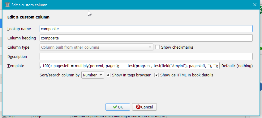

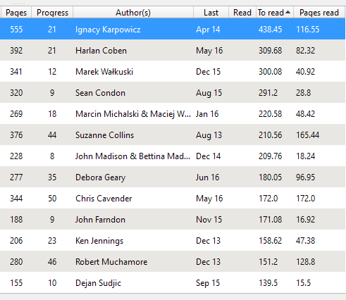

ID:	149233   Click image for larger version

I've tried sorting on my other computer: same results. The computer runs on Windows 8.1 64-bit (also the Polish language version).
Joanna is offline   Reply With Quote
Old 06-05-2016, 06:29 PM   #15
Posts: 22,863
Karma: 34252730
@Joanna - maybe it's something in Windows->Regional Settings->Advanced Settings->Numbers. FWIW - mine are:
