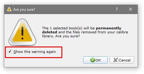

Old 06-04-2016, 03:39 AM   #12
Posts: 22,036
Karma: 30277960
Originally Posted by C-novice View Post
Thanks BetterRed,
I empty my trash quite often. Not sure where to locate 'Remove book confirmation' so that may not be it?
When you delete a book - you 'should' see the following
Unless you unchecked the 'Show this warning again' box on a prior occasion.
In that case if you inadvertently do a delete the delete is done, no questions asked. Example - you accidentally tap the Del key on the numeric pad (usually between the '0/Insert' and 'Enter'), or you tap the Del key when you wanted End (IIRC they're adjacent on some Toshiba laptops)
To restore the confirmations click the Reset all disabled confirmation messages button in Preferences->Behaviour
