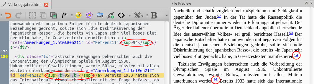

Edit book/Check book/Parsing failed: Inconsistencies in counting
Aim is an uniform (unbold) endnotes format.
<sup>94</sup> vs. <sup><b>95</b></sup>
My relevant regex skills are still basic, so simple F&R and Replace all.

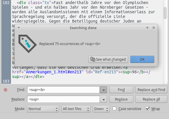

Name:	Searching done_Replaced 75 occurrences.png
Subsequently, in a second step, the rest would then done.
Find: </b></sup>
Replace: </sup>
