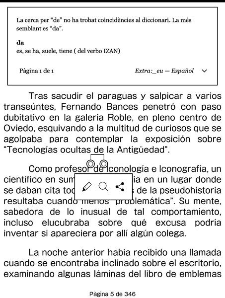

Step by step to install new dictionaries in kobo readers. It serves for dictionaries of another languages and install additional dictionaries of languages installed.
Updated post to work with fw v.4.22.15190
Inspired by the contributions of Robik and Pipcat in https://www.mobileread.com/forums/sh...30#post3311930
You must search dictionaries in kobo format. See in https://www.mobileread.com/forums/sh...ght=dictionary or prepare with Penelope (https://github.com/pettarin/penelope).
1.- Patch the libnickel.so.1.0.0 file with the method geek1011 patchs. Download your firmware patches:
https://github.com/pgaskin/kobopatch-patches/releases
Edit the file libnickel.so.1.0.0.yalm and enable `Allow searches on Extra dictionaries` patch:
Allow searches on Extra dictionaries:
- Enabled: yes
# See https://pgaskin.net/dictutil/dicthtml/install
- FindBaseAddressString: "\0Extra:\x20"
- ReplaceString: {Offset: 7, Find: "\x20", Replace: "_"}

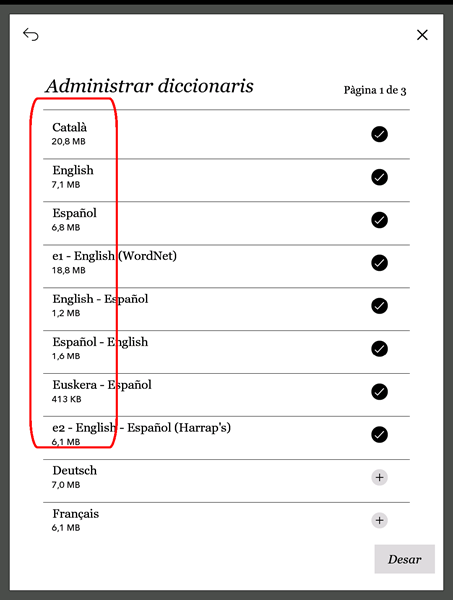

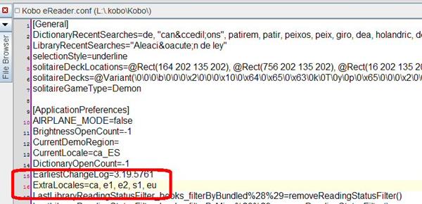

2.- We need a two chars code for each dictionary. If language doesn't exists on Kobo we can use its ISO-639-1 (Ex: Catalan => ca. Euskera => eu), otherwise we will assign a new fictitious code (Ex: English => e1, e2 . Spanish => s1)
3- Edit \.kobo\Kobo\Kobo eReader.conf and fill ExtraLocales=xx in [ApplicationPreferences] seccion with the two chars code of the dictionaries to install (separate with commas)
ExtraLocales=ca, e1, e2, s1, eu

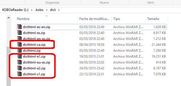

4.- Copy dictionary files to \.kobo\dict
You have to name the files with the file structure of kobo dictionaries with the two chars code.
dicthtml-ca.zip, dicthtml-e1.zip, dicthtml-e2.zip, dicthtml-s1.zip, dicthtml-eu-es.zip
5.- From fw 4.22 step 5 is no longer necessary
6.- Safely disconnect the reader and restart.
You have the new dictionaries.

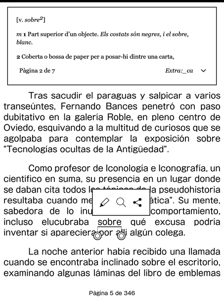

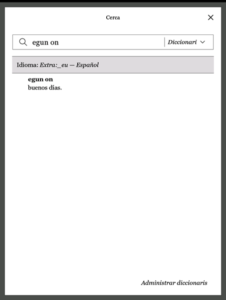

You can use on the book and from the menu dictionary of the home

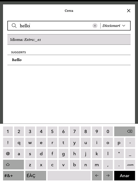

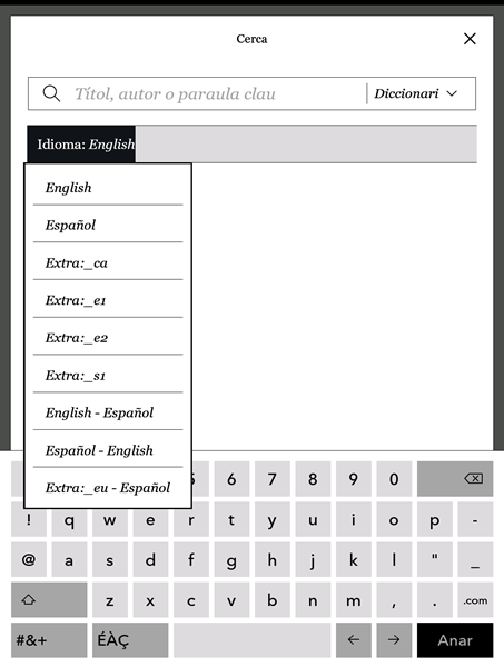

Can you confirm that the names of the dictionaries in the popup menu? is Extra: _e1 or Extra: e1 (with or without "_")?
surquizu is offline   Reply With Quote
Old 05-06-2016, 04:13 AM   #4
MGlitch
Posts: 2,899
Karma: 23142258
Join Date: Aug 2014
Extra: e1 is the format that appears. I just tried using ca and ru to test, and while they still change what appears in the dictionary menu when looking up a book, the error is the same.
I also just tried disabling the patch, which had no affect that I can see.
If appers Extra: e1 (without "_") is because you have not applied the patch. That is why it does not work. You can try to put the next patch (only for 3.19.5761)

MGlitch, are you on fw 3.19.5761 ? I only tested the patch with this version.
If you see "Extra: e1" patch is not applied, otherwise you should see "Extra:_e1".
That space character causes the error when searching. The patch should change that space (\x20) to '_'.

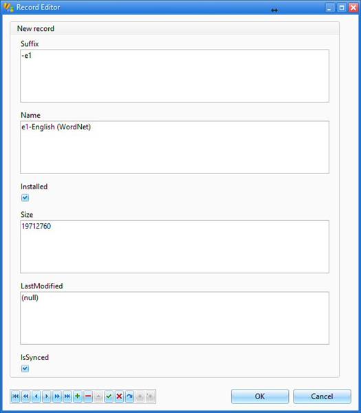

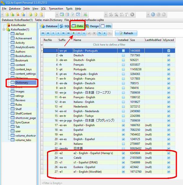

In the "Name" column of the KoboReader.sqlite database, all addtional languages must now be preceeded by an "Extra:_" (e.g. "e1" -> "Extra:_e1"). In addition, the entries for "ExtraLocales" in Kobo eReader.conf must now exactly match the "Name" of the dictionary languages (and no longer the corresponding "Suffix") in the KoboReader.sqlite database without the "Extra:_" prefix. While the e1, e2, etc dictionaries ("Name" of language - "Extra:_" = "Suffix" of language) would still work after adding the "Extra:_" prefix in the databse, you would have to either change, for example, the "Euskera" in the "Name" column of the database to "Extra:_eu" or replace the "eu" in the "ExtraLocales" line in Kobo eReader.conf by "Euskera" (in addition to adding the "Extra:_" prefix in the database to go from "Euskera" to "Extra:_Euskera").
If you want to use the full name, maybe because it looks nicer in the language and dictionary settings or when you choose your dictionary from the look-up window, there's one limitation I came across: if you don't use the latin script for the language name it can be difficult (due to different encodings in the database and .conf file?) to find an exact match: I can't get to match "Extra:_Русский" from the database to "\x420\x443\x441\x441\x43a\x438\x439" in the .conf file (both rendered as "Русский" in the GUI).

Originally Posted by taos View Post
Almost.
It does not work (for me) if you use any name different of e1, e2, ... in the database and/or the file kobo ereader.conf. I have tried as you say Extra:_euskera as name in database and euskera in the config file without success. I have tried other names, always following the rule you mentioned: database name: Extra:_XXXX, name in config file: XXXX and . Only Extra:_e1 in database and e1 in config file works.
JIPG-reader is offline   Reply With Quote

I have the following additional dictionaries installed:
Suffix | Name | ExtraLocales
-da-en | Extra:_Dansk - English | Dansk
-la-en | Extra:_Latina - English | Latina
and since ExtraLocales doesn't like cyrillic script:
-ru-en | Extra:_ru - English | ru
Complete line in Kobo eReader.conf:
ExtraLocales=Dansk, Latina, ru
All of these dictionaries still work for me with the latest firmware (although the ones with the full names are shown as English - English in the look-up window).

In my case, I want to add an additional Spanish dictionary, not a translation one from one language to another.
So, I use only one sufix, and per surquizu instructions, I expected to put a name to better remember the dictionary name: e.g. Extra:_DRAE. But if I do
-e1 | Extra:_DRAE | DRAE
it thinks it is an English dictionary and it does not work.
If I do
-e1 | Extra:_e1| e1
It works and appears as EXTRA:_e1 in the look up window.
