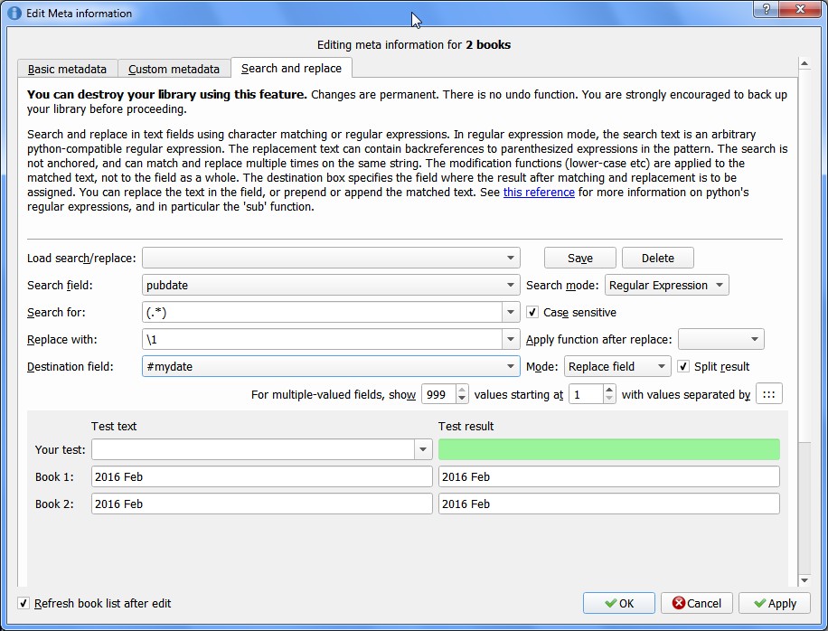

I tried it using the latest source. Here is the screen capture of the S/R.
The two dates have different format specifiers.

I'm not running from source but, if you tell me which file I should download from git (I have the tar file for the last release) I can try. Anyway, my S&R screen looks exactly the same than the screen you've posted, with the origin field "pubdate" and the destine field "#fpb" (dd/MM/yyyy).

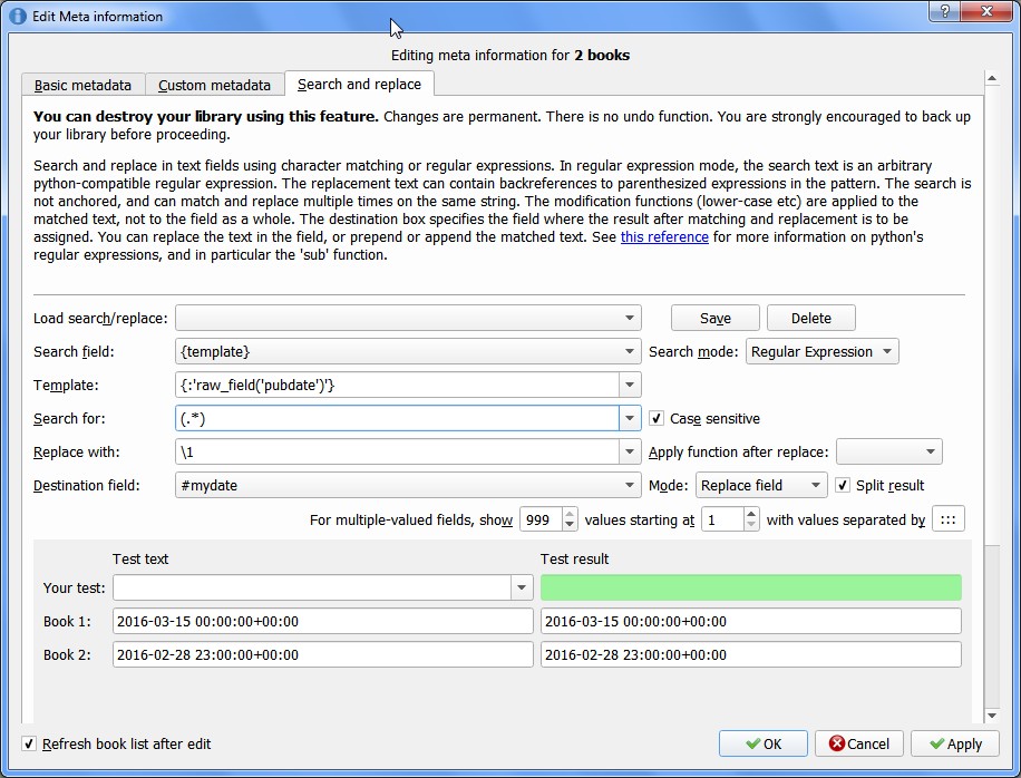

@Terisa de morgan: you can leave the tweak as it was if you use something like the following for the S/R. The trick is to use a template as the source. The template uses the raw_field function to avoid any formatting of the date.
This technique has a second advantage beyond "working": all the date fields are available when setting the destination. This means that if the source has the value 2016-3-27 but displays as March 2016, the destination will still have the "27" to work with.

Thank you very much, I'll change the expression in that way, as I would never have thought about the displayed format as a problem And I've learned something I didn't know for S&R => template
