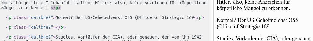

keine Anzeichen für körperliche Mängel zu erkennen. </p>
  <p class="calibre2">Normal? Der US-Geheimdienst OSS (Office of Strategic 169</p>
  <p class="calibre2"></p>
  <p class="calibre2">Studies, Vorläufer der CIA), oder genauer, der von ihm

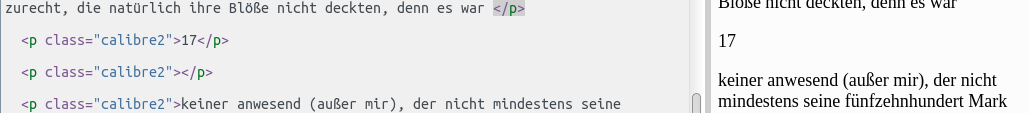

die natürlich ihre Blöße nicht deckten, denn es war </p>
  <p class="calibre2">17</p>
  <p class="calibre2">keiner anwesend (außer mir), der nicht mindestens seine

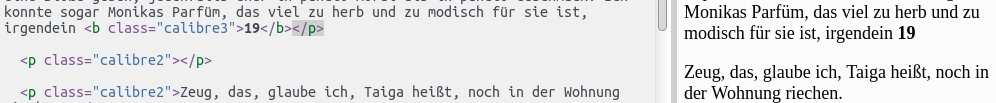

das viel zu herb und zu modisch für sie ist, irgendein <b class="calibre3">19</b></p>
  <p class="calibre2">Zeug, das, glaube ich, Taiga heißt, noch in der Wohnung

I don't believe there is a collection like that. Once you really learn the basics (by reading regular-expressions.info), you could really come up with all the Regex by yourself. That is what I do for the most part, I just create them on-the-fly as I need them... because each book's code comes with its own problems.
As you can see, a book might have:
  • a bold page number
  • an italic page number
  • a page number on its own line
  • a page number in the middle of text.
  • a bold+italic page number
  • <b class="calibre#">###</b>
  • <b class="block#">###</b>
  • <span class="pagenumber">###</span>
  • <sup>###</sup>
It would make no sense to create a giant list of Regex for each of those... because they all follow the same basic rules!
I would just visit regular-expressions.info and follow along with the tutorials. It has lots of examples to learn from!

INHO what is also important is the ORDER you fix them. If you don't get it right, the next fix (or join) will be more difficult
Yep! And this is why you should try to normalize/clean the code as much as possible FIRST.
For example, here is some hideous code right out of an InDesign EPUB:
<p class="body-text" xml:lang="en-us"><span class="no-style-override-5">The point is, as we can readily see, the ability to</span> <span class="no-style-override-4">foresee</span> <span class="no-style-override-5">an event is not at all equivalent to</span> <span class="no-style-override-4">agreeing</span> <span class="no-style-override-5">to it. Yes, I can full well</span> <span class="no-style-override-4">predict</span> <span class="no-style-override-5">that if I move to the South Bronx, I’ll likely be victimized by street crime. But this is not at</span> <span class="no-style-override-4">all</span> <span class="no-style-override-5">the same thing as</span> <span class="no-style-override-4">acquiescing</span> <span class="no-style-override-5">in such nefarious activities. Yet, according to the “libertarian” argument we are considering, the two are indistinguishable.</span></p>
First thing I do is go through the code and strip it down to this:
<p>The point is, as we can readily see, the ability to <i>foresee</i> an event is not at all equivalent to <i>agreeing</i> to it. Yes, I can full well <i>predict</i> that if I move to the South Bronx, I’ll likely be victimized by street crime. But this is not at <i>all</i> the same thing as <i>acquiescing</i> in such nefarious activities. Yet, according to the “libertarian” argument we are considering, the two are indistinguishable.</p>
and then it makes it much easier to do later fixes.
Diap's Editing Toolbag is great for cleaning up code:
https://www.mobileread.com/forums/sho....php?p=2980740
It is also great for helping get rid of a ton of the useless classes (<span class="no-style-override-5">), or changing certain tags into other tags (<span class="no-style-override-4"> -> <i>).
Each book is different, so you can't just have a big list of "Regexes to clean page numbers" that you can run on Book A + Book B + [...] + Book Z.
And with Calibre conversion code on top of this... the calibre# classes are completely different in each EPUB:
  • calibre2 in Book A might be the page numbers
  • calibre2 in Book B might be italics
  • calibre2 in Book Z might be headings
And all of the above in the same book (OCR of scan)
I remove all Page Header type (Section/Title or Author) With a page number first (this is more than 1 template as there are right - left side variations)
Headers/Footers in the actual text? Ouch. I haven't run across that one in quite a few years. What tools are being used to create that? I know Finereader does a pretty great job at ignoring Headers/Footers, and never exporting them in the first place.

@Tex2002ans: Example # 5 works fine with Search: *SPACE*\[[0-9]+\]
It is strange, I had known, only it had not occurred to me yesterday.
