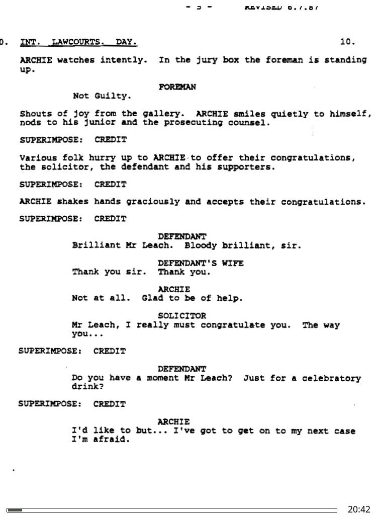

For reading epubs on the Kobo, I use exclusively the original software, which gives me a very nice reading experience. But if it comes to pdf files, I use Koreader. If the book has a simple layout, Koreader's reflow mode does a very good job. If the layout is less simple, e.g. if there are notes or something of that kind printed on the left or right margin, then that would require some more adjusting (or dispense with reflow), which I am usually not willing to do. So whether you will be satisfied by Kobo might depend on the kinds of pdf files you are reading.

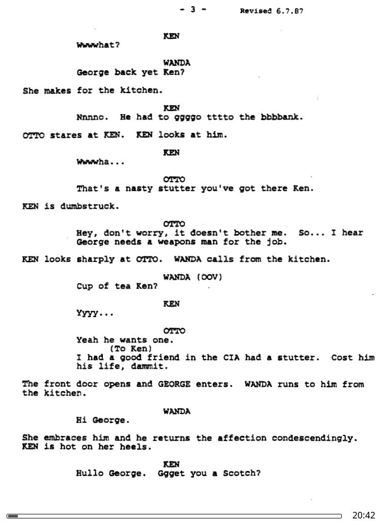

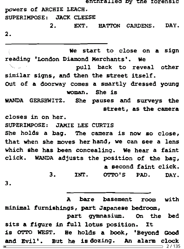

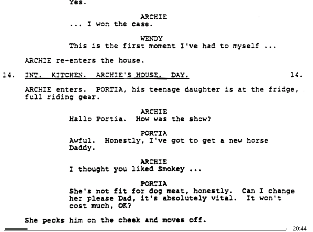

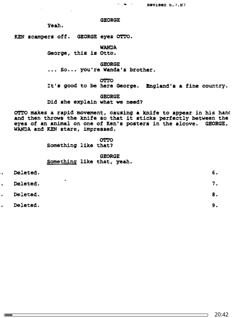

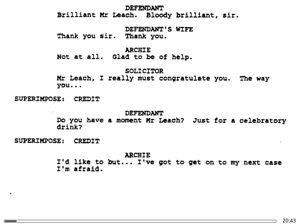

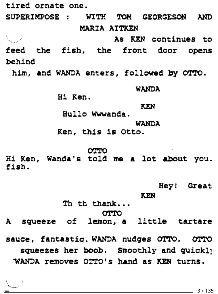

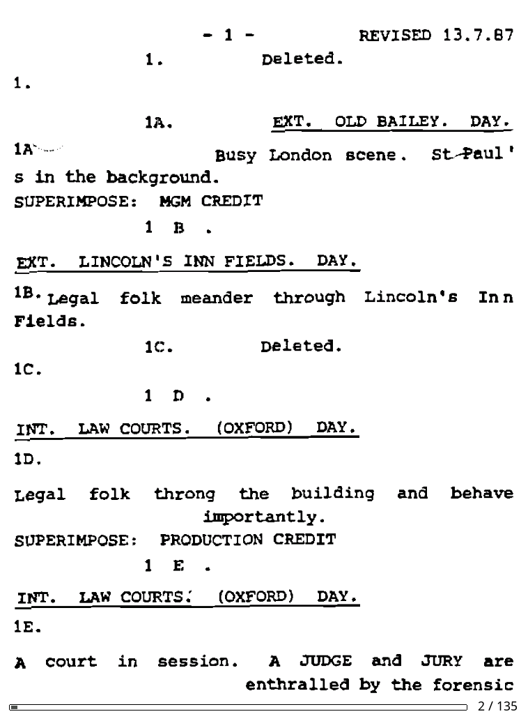

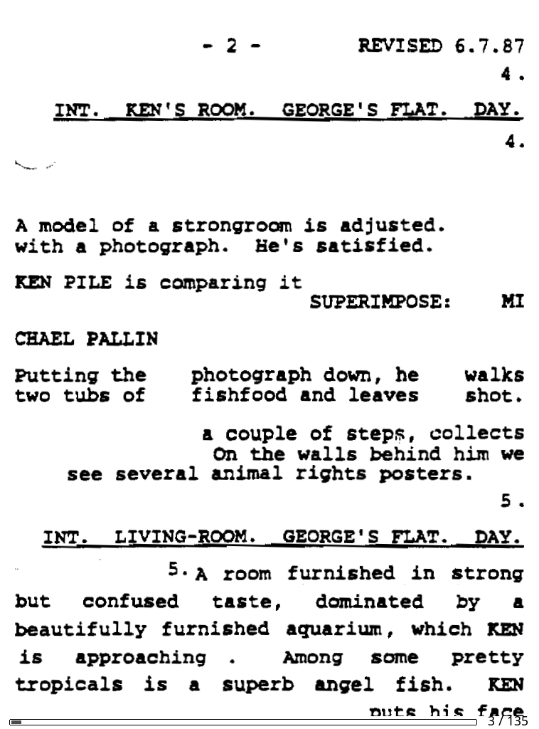

Reflow does not work very well with this kind of layout; see images 1 to 4.
I then cut the large borders (That was rather easy to do in Koreader. I tried it for the first time, and it was done in about 10 seconds. I did however cut to much on the left and at the top! I should have spend some seconds more.); see images 5 to 7.
In order to get a more comfortable font size (at least for my eyes) I chose landscape view; see images 8 to 10.
