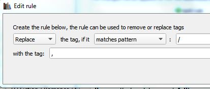

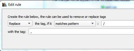

@fidvo,
I just ran tests on this. It doesn't work for me.
I choose the rule: Replace..... Matches Pattern..... then the only thing in the field is SPACE/SPACE.
I told it to replace with a ,(comma).
Nothing changes when running. When I go back to the rule, the leading space before the / has disappeared; so does the leading if possibly not necessary space before the comma. I fix, yet it returns.
Are you sure this is all you typed in and had success with?
I've attached pics in case this isn't clear.

Old 04-12-2016, 10:47 PM   #8
jecilop
jecilop will be dicovering the secret to cold fusion any day nowjecilop will be dicovering the secret to cold fusion any day nowjecilop will be dicovering the secret to cold fusion any day nowjecilop will be dicovering the secret to cold fusion any day nowjecilop will be dicovering the secret to cold fusion any day nowjecilop will be dicovering the secret to cold fusion any day nowjecilop will be dicovering the secret to cold fusion any day nowjecilop will be dicovering the secret to cold fusion any day nowjecilop will be dicovering the secret to cold fusion any day nowjecilop will be dicovering the secret to cold fusion any day nowjecilop will be dicovering the secret to cold fusion any day now
Posts: 260
Karma: 139980
Join Date: Mar 2014
Device: Android
@fidvo,
I just ran another test. I have to wonder if you actually tested a Replace/Matches Pattern rule.
As set up, that only works for a tag that is ONLY a forwardslash / .
I created a tag " / " . I easily replaced that with just a comma using Matches Pattern.
BUT, I'm talking about a forwardslash that is CONTAINED IN A TAG EXPRESSION. Therefore, there has to be something else to code to convey this.
A simple SPACE/SPACE and comma replace works with Search and Replace, but it doesn't work in the Tag Mapper which is the preference as my rules will "fix" the items such separation would create so I'd like it to be automatic vs the Search and Replace method that would require running it on tens of thousands of entries all at once since it would be more time consuming to "find" tags expressions containing this.
