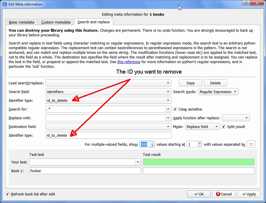

I just tried it and it works fine.
The trick is to set the id to an empty value. That removes it. Here is an example screen capture:
Ah
