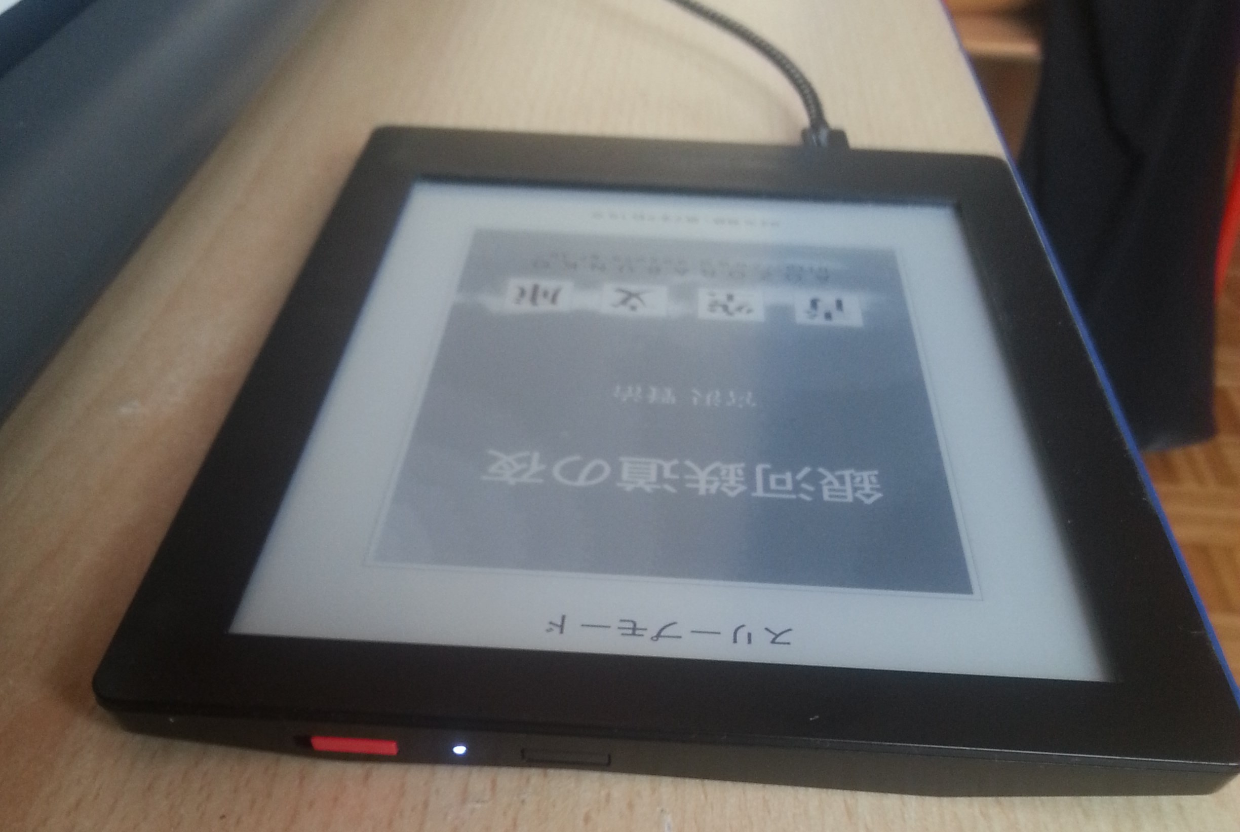

Nothing looks unusual on the screen. See pic 1.

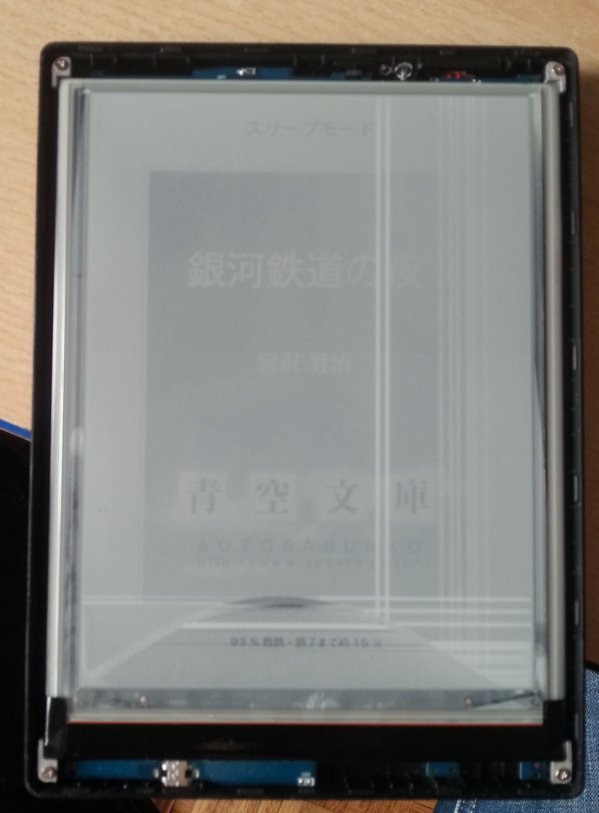

Pic 2: While doing the factory reset the notification light quickly blinks while nothing is going on on the screen.
Attachment 147203

The only thing I can see is a line across the screen just above the bottom edge of the cover. But it doesn't look like a typical broken screen.

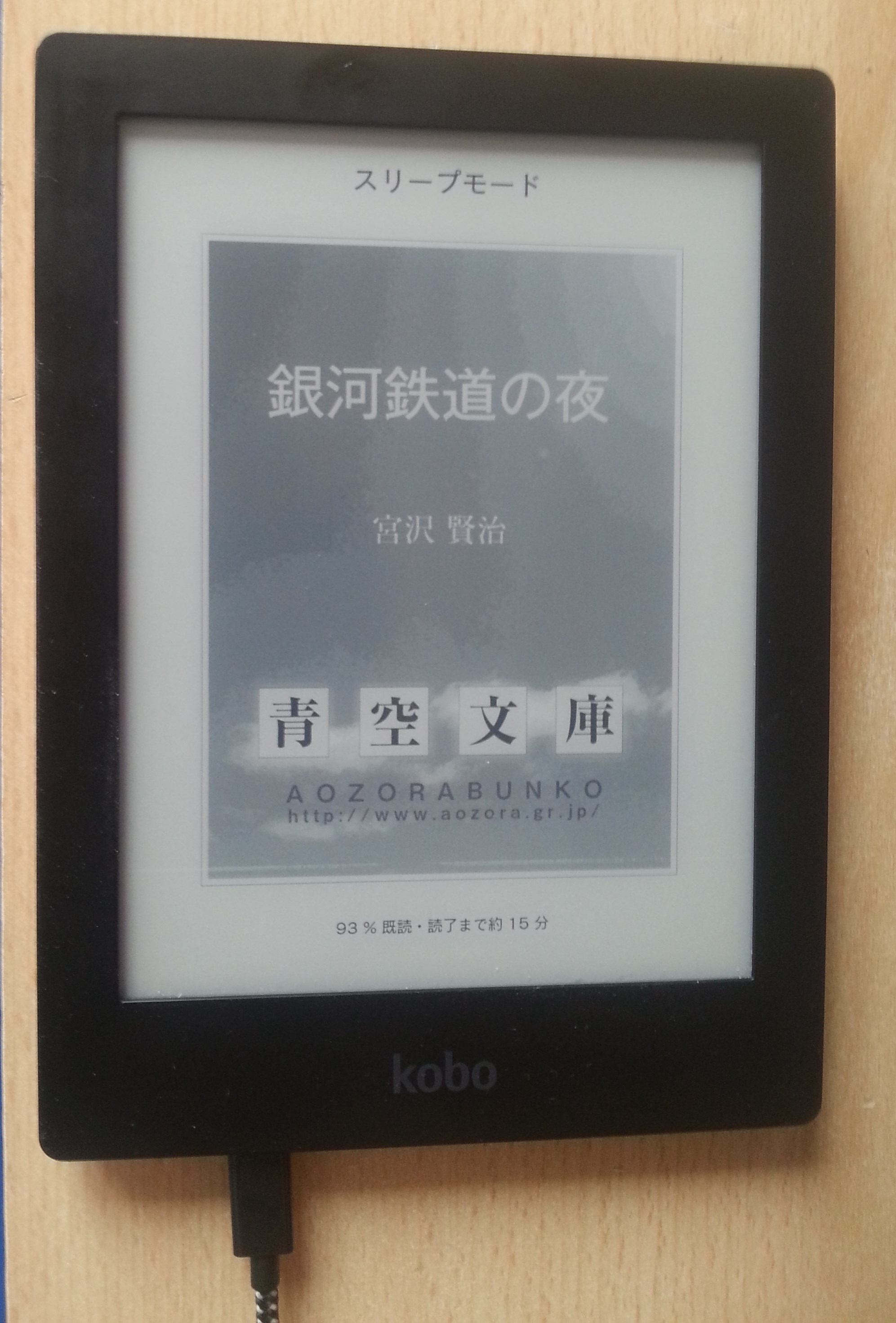

Update!
After putting the lid off I tried to turn it on again and the screen did react a bit.
Pic: Click image for larger version

This pretty much confirms that the screen is broken doesn't it?
Is there any point in checking the battery and reinstalling the firmware on the sd card?

Looks like it to me, sorry. Not much point, other than as practice or to fiddle with it.
