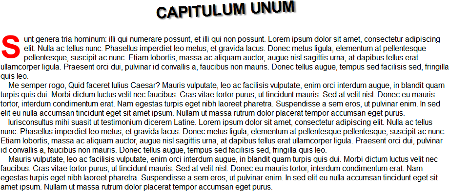

And here are some images to help visualize.
With CSS3 (text-transform + text-shadow + transform):

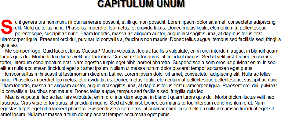

Without text-transform:

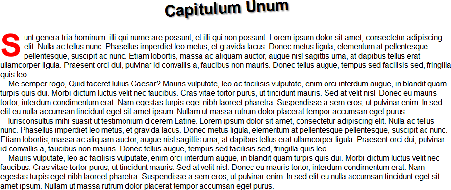

Without text-shadow:

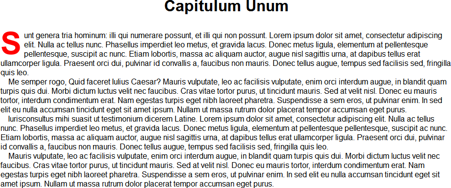

Without any:

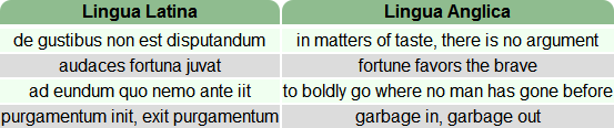

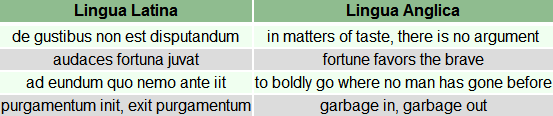

Or even something as simple as:
border-top-left-radius: 10px;
border-top-right-radius: 10px;
which gives you rounded corners:
ID:	146956 Click image for larger version
