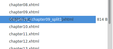

Though bulk renaming is easy, one of the difficulties I have with the Editor is to change the name of one text file. Changing only one name can be tricky (see screenshot with black and white writings...) because the real path (../OEBPS/Text/chapter1.xhtml) can be different from what we see on the screen (chapter1.xhtml), and is interfering so much with the renaming process that sometimes I don't understand what I am doing.

How are you getting black and white text simultaneously? Renaming a single file looks like this. What OS are you on?

Archlinux 64 bits for Calibre 2.5.1. direct download.
It has been like that for quite a while.

My screenshot was also on arch. Make sure you are using the calibre style in Preferences->Look & Feel->User interface style (main calibre preferences)

I selected the other value which is "Calibre style" and I get the same view as you. Life is simple indeed.
