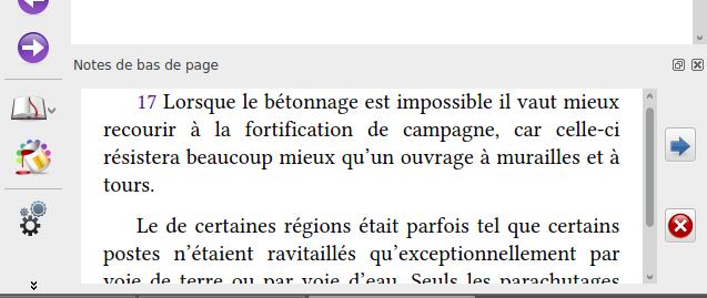

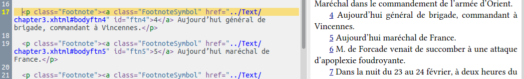

- The -basic- code of two footnotes I see written in the Editor (right screenshot)
- When I click on ftn17 on the viewer, the footnote is displayed this way (left screenshot). Ftn17 is correctly displayed but it also appears a part of Ftn18 (though not the small word in italics).
Ftn18 display is not requested this time and should not appear in the viewer. What triggers it? How to avoid it? Is there something wrong in my code?

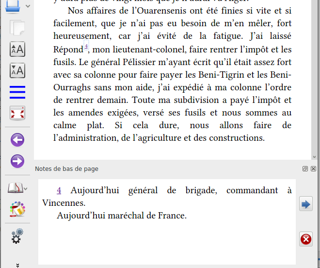

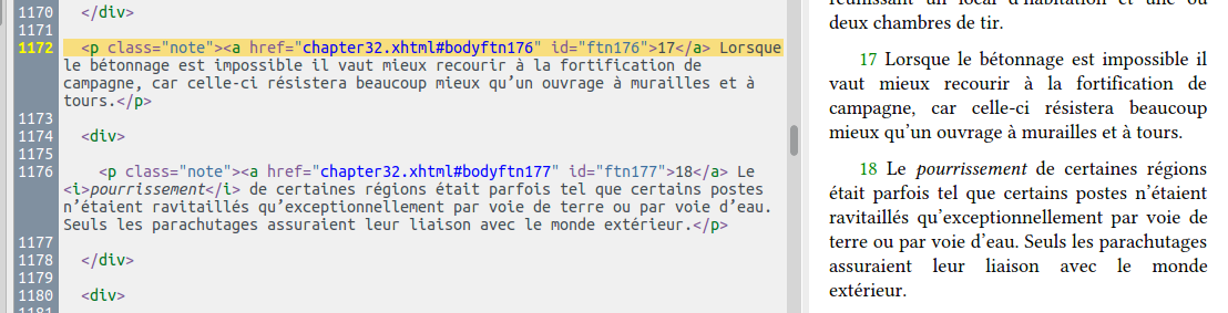

I can provide other examples where the new footnote appears when it should not and without any div this time. This "extra" display of the next footnote seems to stop when it finds a span or another tag like the i.
I don't use the Adobe viewer because I use Linux.
Two other screenshots from another book (without div) with the same "next" display.

Here is an attached EPUB2 which displays in the Viewer only one footnote at a time because the id attribute has been moved from the a tag to the p tag. Also included is the regex (in .json format) I used to move the ids for the seven endnotes.
Yes, that's the way to do it. And as footnotes tend to be a single paragraph, it will work well.
So no EPUB3 attribute is used.
This is OK in the Viewer, it remains to be seen how it displays on other software.
Of course, when producing an EPUB3, there will be a need for a new regex.
