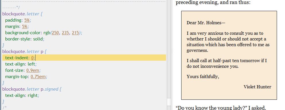

Looking for CSS suggestion to set off snail-mail
In some of the epubs I cleaned, there is a letter from someone in the text
I used to just use a <blockquote> around it, but I thought I could set it off a little more with some CSS.
The attachment is the best I could come up with (very simple and not overly formatted)
Does anyone have some CSS that they use which I could consider using to set off a letter?
Thanks

Old 01-17-2016, 08:49 PM   #2
Posts: 22,141
Karma: 30317706
If I were to right align the signature I would also right align the Compliment, and assuming there's no actual signature, I probably wouldn't have any space between the Compliment and senders name.
A Victorian Miss suited to be a governess would not send an undated letter - also right aligned
And if she used someone's name in the Salutation she would use 'Sincerely' in the Compliment, probably without the 'Yours' - unless she was being deliberately flirtatious
Not arguing, but that's what Sir Arthur Conan Doyle wrote
Agree about right justifying the Complement
BTW, I tried to use a 'Parchment' jpg as a background-image and it really didn't work well, so the RGB I tried has a color name of Parchment
Any ideas / suggestions about the border -- change, delete??
Old 01-17-2016, 10:14 PM   #4
Posts: 22,141
Karma: 30317706
Firstly, complement and compliment are not alternative spellings of the same word. Secondly, what would an unmarried Scot know about potential Victorian governesses :lol:
I wouldn't have a background image, IMO the margins are enough. If you use a background image to lend 'authenticity' it begs the question - would all correspondents use the same paper. Probably not, Her Ladyship is unlikely to use the same paper as His Lordship's man-of-affairs.
However if you insist, for that letter I would use low-grade white cut edge paper, whereas for Holmes' reply I might use a sheet of dove-grey deckle edge Italian paper - at $3 a pop
Old 01-17-2016, 10:26 PM   #5
Posts: 31,414
Karma: 62503914
Think about Mono-chrome (and lower contrast) devices: Skip the background
The Blockquote, Border and a different font face (eg cursive) should be enough to convey a character generated missive
Old 01-17-2016, 10:35 PM   #6
phossler
Posts: 1,092
Karma: 447222
Device: Kindle Paperwhite
Blush - my math major background is showing ('complementary angles, etc.')
I guess that's why Holmes makes the big bucks (or pounds)
Seriously, thanks for confirming no BG image (especially if I have to figure out the appropriate stationary) and I'll just go with the extra margins and the background-color. IMHO it provides just enough of a difference to indicate that the letter text is something other than just body text without being too 'cutsey' and shows on my reader
Old 01-17-2016, 10:42 PM   #7
phossler
Posts: 1,092
Karma: 447222
Thanks, this is just for me so it doesn't need to be too 'universal'
I had not really thought about a cursive or script typeface, but I think I'll experiment and see how I like it.
I think that your typeface suggestion and BetterRed's ideas are simple enough to add to the CSS and also not be overwhelming. If I go with the typeface, then I wouldn't need a BG color.
Thanks

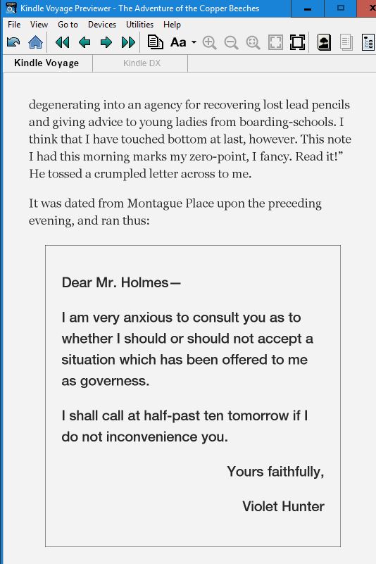

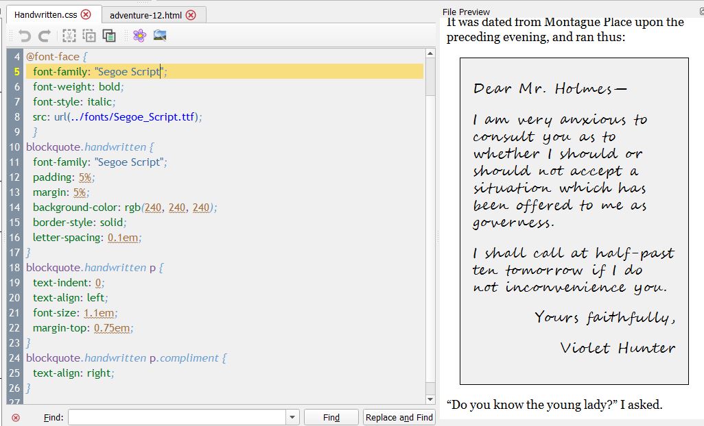

I tried Lucida Handwriting
No Joy
Both ADE and Kindle Previewer don't show the 'scripty' font, even with [Publisher Fonts] enabled. The editor renders the typeface correctly
I don't know if it's something with the typeface or what.
I suspect that I'll stay with the body text typeface, but just set it off somehow
No Joy
Both ADE and Kindle Previewer don't show the 'scripty' font, ...
Perhaps just using italic, along with the margins and/or <blockquote>, will work for you. Had the narrative been more modern, a monospace font spec would work, simulating a typewritten letter.
Staying with the reader's basic fonts can be more reliable than trying to properly embed a custom font and deal with a fall back for readers that don't support the embedded font.
dwig is offline   Reply With Quote
No Joy
Did you embed the font?
Did you make the proper @font entries?

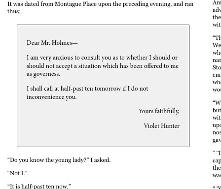

Old 01-18-2016, 02:25 PM   #14
phossler
Posts: 1,092
Karma: 447222
@ theducks
Yes & yes
The screen shots are from my other test using Segoe Script, but the Lucida results were the same
Any thoughts or ideas?

Old 01-18-2016, 03:20 PM   #15
Posts: 31,414
Karma: 62503914
The font weight does not match
You declared family was for BOLD
but you did not use Bold for the letter
You can use a bold font, but declare it (use) as normal in the @font
