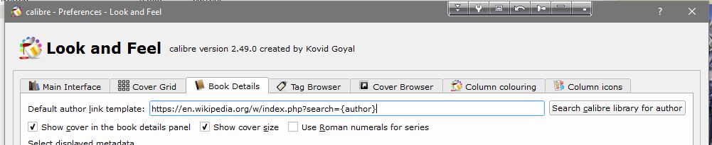

@mariaclaudia - it works fine for me
In my journals library, all authors have a unique value in the Manage Authors author_link field, they are urls to notes in an Evernote database. The value of the author_link remains as it was when I add new 'books' for an existing author

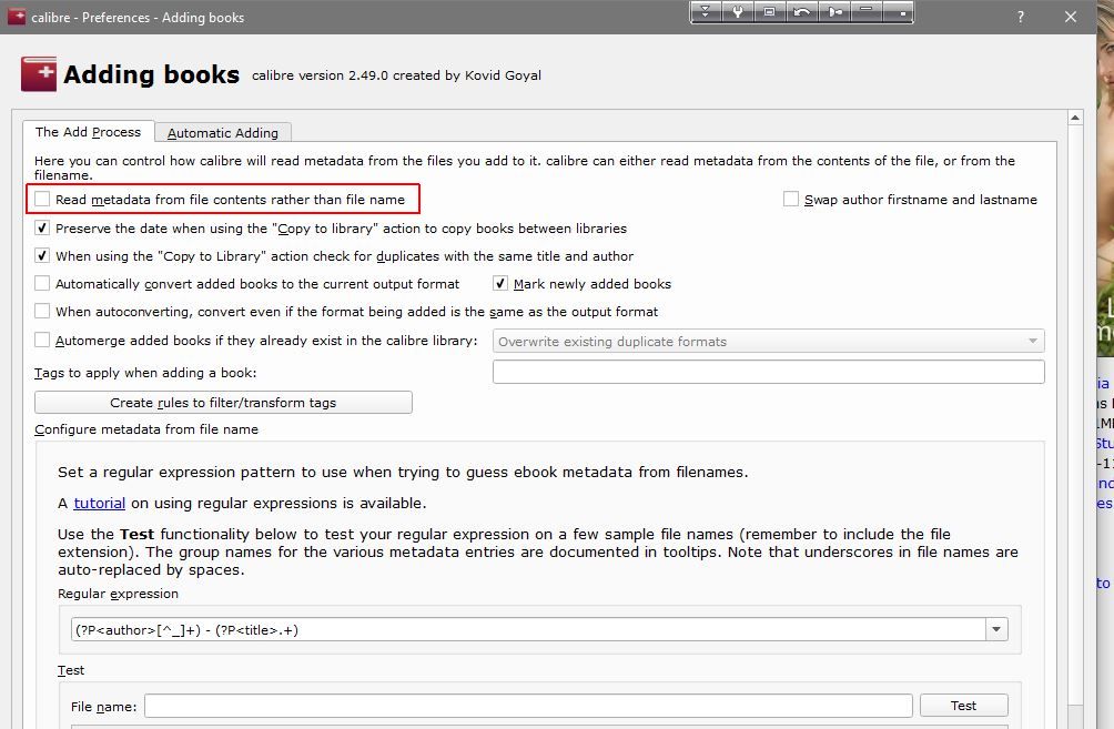

@mariaclaudia - in my previous post I asked about this setting
Is the first setting ticked or not ticked ?
And can you confirm that in this setting,
where I have
https://en.wikipedia.org/w/index.php?search={author}
you have
https://www.google.com/#q={author}

Ok, about the first question, I have ticked, and for the second question, I have https://www.google.com/#q={author}

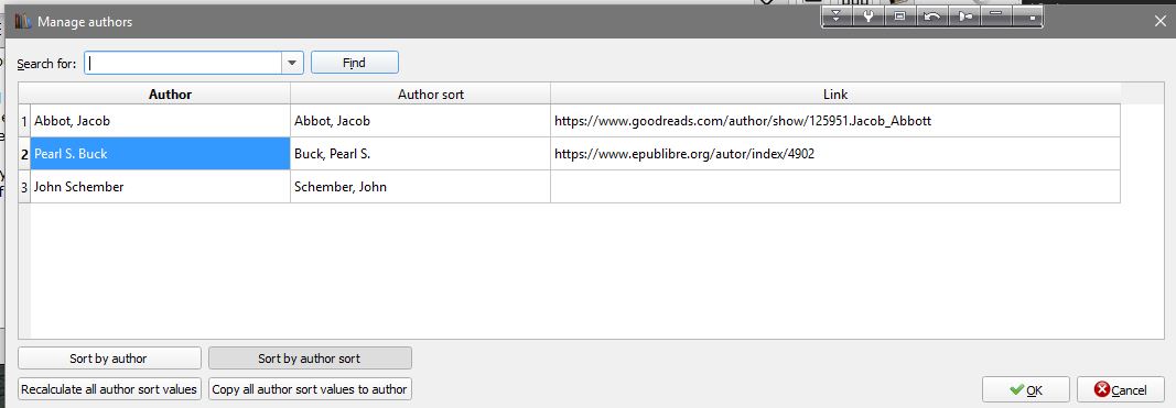

@mariaclaudia - I cannot replicate your problem at all.
What format are the downloads - EPUB, MOBI... PDF ??
Do you have the DRM Tools installed?
Do the books you're adding have DRM protection?
I don't use the tools, almost all of my e-books are public domain texts. When reading for pleasure I prefer paper.
I just did this test
  • I installed a fresh copy of calibre portable version 2.49
  • I made one change to preferences - replaced the Wikipedia link in Look and Feel->Book Details with the Google link.
  • Downloaded two books from here :
    https://www.mobileread.com/forums/showthread.php?t=48487
    https://www.mobileread.com/forums/showthread.php?t=48310
  • I added the first book (Charles II)
  • As expected clicking Author took me to Google
  • I went into manage authors and put -- https://www.goodreads.com/author/show/125951.Jacob_Abbott -- into the Link field for Jacob Abbot
  • As expected clicking Author now took me to Jacob Abbot's page at Goodreads
  • I added the second book (Genghis Khan)
  • Clicking Author still took me to Jacob Abbot's page at Goodreads
My only suggestion is that you try repeating what I did. Those are 'well formed' EPUBs with no DRM - thanks to MR member crutledge.

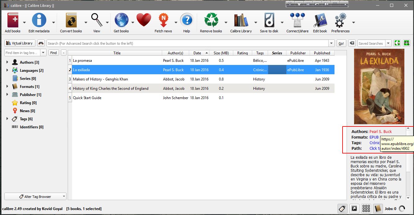

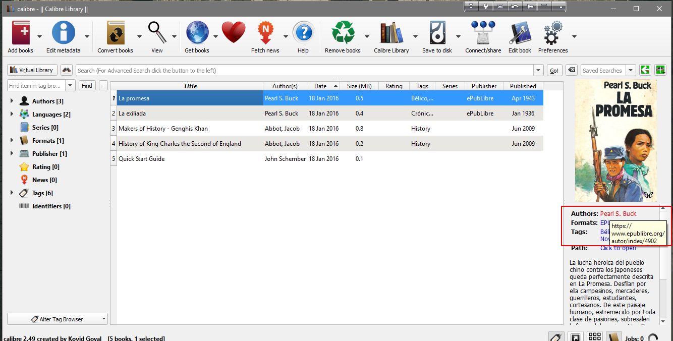

I downloaded La Exilada and La Promesa by Pearl Buck from epublibre.org, added La Exilada then entered her epublibre.org page into the Link field, it worked of course. I then added La Promesa and the link to epublibre.org still works See attached screen shots
You can see in the screen shots that it picked up the Publisher, Published Date and Tags from the inside the file, as well as the Author and Title.
Which operating system do you use - Apple OSX, Linux or Microsoft Windows? If Windows which 'edition' of calibre, 32 bit, 64 bit or Portable - I have tested 64 bit and Portable.
Aside : after the add, the Title Sort had 'La promesa' on pink, to 'fix' it I had to hit the button between Title and Title Sort which changed it to "promesa, La". The Author Sort field had "Buck, Pearl S." on green. I do not know if the book's language (Spanish) has any role to play in this, or the fact that it is different to the calibre interface language or my language setting in Windows. But I wouldn't think any of that has anything to do with the Author Link field - but maybe I'm wrong.
All Preferences with the exception of the L&F->Book Details->default author link template are the default settings.

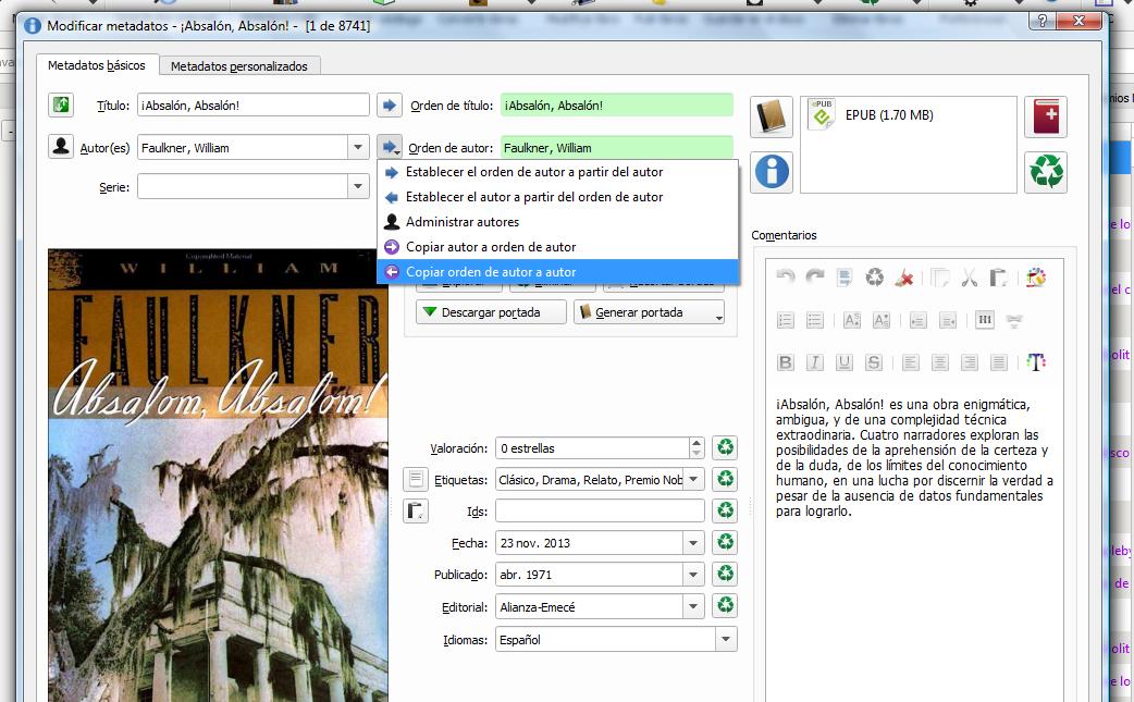

The problem is when you open the metadata editor for the new book. Don't use the "Copy author sort to author" to fix the author name. Use the author drop-down to find the existing author called "Scott, Walter".
What is happening is:
- You have an author called "Scott, Walter" with the author sort of "Scott, Walter".
- You then add another book whose author is "Walter Scott". This creates a new author called "Walter Scott" with the author sort of "Scott, Walter".
- In the book metadata editor, you use the "Copy author sort to author". This renames the author "Walter Scott" to "Scott, Walter".
- As there already is an author with that name, calibre is replacing the existing author with the new author. Hence, you lose the link.

Now, because I have a spanish version, let me ask you something: where is the author drop-down option you said? I proceed as you see because some times I add many books by many authors, so, it's the easy way for me. Thanks for answer!!!!

Use the arrow at the right of the Author field.

Do you mean this?
[Image too big - replaced by attachment]
mariaclaudia is offline   Reply With Quote
Old 01-27-2016, 06:44 PM   #15
davidfor
Posts: 24,905
Karma: 47303828
Location: Sydney, Australia
No. As part of the author field, at the right end, there is an arrow. When you press that, it drops down a list of all the authors in your calibre library. You can select the author you want. Or, you can start typing the name, and the drop down will show, but it will be filtered to names that match what you type.
