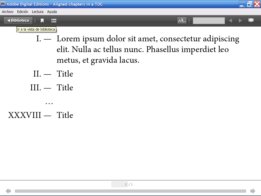

Hmmm, what about using a table for that? A two column table with "text-align: right" for the first column and "text-aling: left" for the second column could work. For example this code works fine under ADE:
td {
   text-align: left;
   vertical-align: top;
td.first {
   text-align: right !important;
and
  <table width="100%" cellspacing="10" cellpadding="0" border="0">
    <tr>
      <td class="first">I.&nbsp;—&nbsp;</td>
      <td>Lorem ipsum dolor sit amet, consectetur adipiscing elit. Nulla ac tellus nunc. Phasellus imperdiet leo metus, et gravida lacus.</td>
    </tr>
    <tr>
      <td class="first">II.&nbsp;—&nbsp;</td>
      <td>Title</td>
    </tr>
    <tr>
      <td class="first">III.&nbsp;—&nbsp;</td>
      <td>Title</td>
    </tr>
    <tr>
      <td class="first">…</td>
      <td>&nbsp;</td>
    </tr>
    <tr>
      <td class="first">XXXVIII&nbsp;—&nbsp;</td>
      <td>Title</td>
    </tr>
  </table>
Here there are two screenshots of ADE (with different font-size):
ID:	145589 Click image for larger version
Below you can check the respective epub.
NOTE: As you can see, I styling "inline" the table; that is because ADE has "issues" with styling tables with code in the .css stylesheet.
Regards
Rubén
