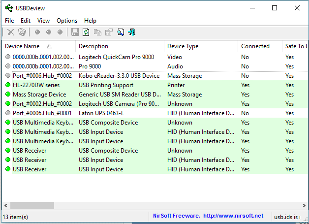

Could you download and install USBDeview. Then plug your Kobo in and run the program.
Select ALL the devices (Ctrl-A) and then do a "Save Selected Items" (Ctrl-S) which will prompt you for a file name. Supply a name, and then after it's been saved, upload the txt file to the forums here.
I'm hoping to see some "extra" settings which might help us figure out what has happened.

USBDeview file attached
Thanks for the response guys....attached is the txt file you requested. I'm also considering doing a fresh install of Windows 10 on one of our laptops and checking another laptop to see if it works.
Cheers...
Mike

I'm not sure what PeterT was looking for, but nothing jumped out at me. What I would try is to use USBDeview to delete the "eReader‐3.19.5613" and "Mass*Storage*Device" devices. But, make sure you don't have the Kobo or any USB memory sticks or drives connected. Then reboot the computer. If you're lucky, it will now work.

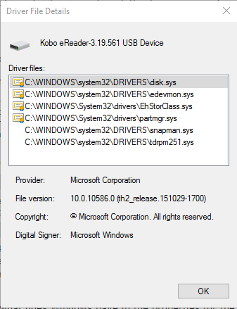

Hey guys...I'm a little slow in responding but still not much joy.
I did the deletion in USBDeview and then a shut down and power up. No dice.
I tried the automount trick using diskpart which is active. There was a mention that a drive letter is not being assigned but it does seem to be assigning the letter (i.
The properties shows that the device was set up for quick removal. I've changed this to best performance but it has not helped.
I've attached the drivers shown associated with the drive in the image below.
I've found that I can still use the device in Calibre by clicking the connect/share and connecting to folder so this is a nice band aid but still not finding a root cause / fix.
Kind regards,
Mike

WOW... What a change in drivers from Windows 7! All I see loaded in Windows 10 are WpdFs.dll and WUDFRd.sys!

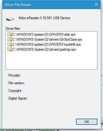

Firstly, for comparison, I have attached a screenshot of the drivers for my Glo HD connected.
Looking at the drivers, the last two are something to do with an Acronis product. And "edevmon.sys" is part of ESET Smart Security. Disabling both temporarily or getting them to ignore the device, might help. But, I don't think they are the problem.
I have "hpdskflt.sys" which is from HP for my laptop. That won't be affecting this.
Everything else seems to match what I have here.
How about starting Windows in safe mode? That should eliminate all unnecessary drivers but the USB drivers should still be available.
