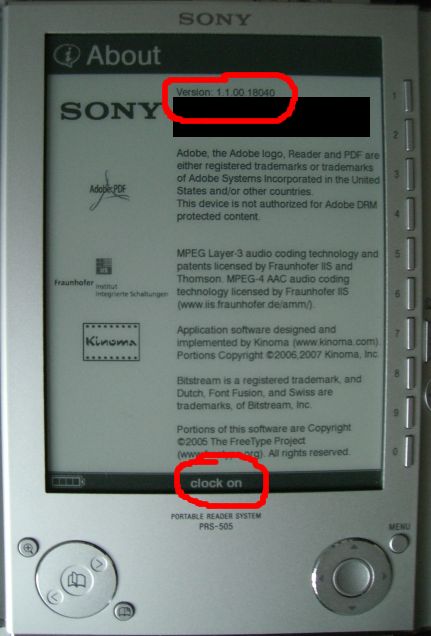

There is new patch ...
1) I tried UniFlasher 2.0 to flash new "russian" firmware ... first I flahed my PRS505 with official flasher to version 1.1.00.18040. Than I found on the-ebook.com the patch with clock, joystick and fonts (,but original not localized menu) ... than I copied UniFlash2 on SD card and add new_opt.img ... started my reader and first clicked on 4 ... it writes that it copied it correctly, than I clicked on 6 and error come, that something "/tmp/... not found".
2) So I used "old" flasher from "hack3.zip" file and added new new_opt.img ---> my PRS-505 flashed correctly and works fine
Now I have new firm with clocks, font(czech font supported) ... see attachment

Old 07-26-2008, 09:40 PM   #11
Posts: 85,402
Karma: 154365103
zemj, if the hacks you just applied were not created under firmware version 1.1.00.18040, what you have done is caused your reader to have incorrect XML files which will either cause you to lose some oof the new features or have them no work correctly.
Try the following, go to a book's menu. Then go to Utilities. If you do not see Delete Book, then you've just screwed things up and will need to reapply the firmware.

Old 07-27-2008, 12:52 AM   #14
zemj
zemj began at the beginning.
Posts: 8
Device: 2 PRS-505,some PDAs
@JSWOLF: porkupan is right, as I wrote it is from the-ebook.com and I have in menu "deleting" ... see the screen, there you can see number of version and down there string "clock on" (this is verrification of new firm with right patch), this is photo of my PRS-505
