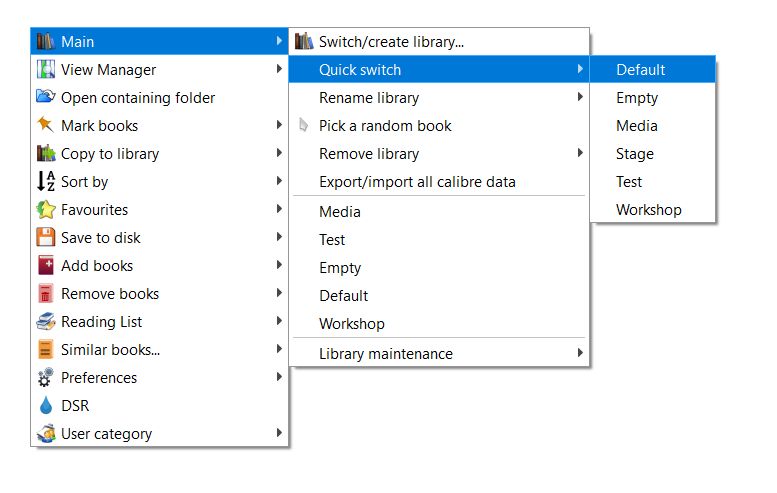

@Capricorn - firstly I don't use the mouse unless I have to, so this is what I do to switch libraries, which I do quite a lot.
I have Select Library at the top of my book list context menu, so I tap the menu key, and then use arrow keys to navigate to the required library and press enter - only suitable for mouse averse context menu lovers
Attachment 160605
Thank you very much, I hadn't thought about this but can be very useful.
