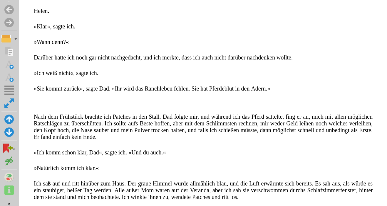

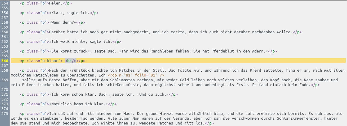

Generous use of empty spaces (Foolish?)
An official e-book version.
Name:	E-book viewer.png
ID:	143245 Click image for larger version
E-book viewer · · · · · · · · · · Edit Book
I criticize the massive use of blank lines.
Reasons
a) Waste of space
b) Nonsensical blank lines do not contribute to overview
c) Increased energy consumption when reading on an e-reader (multiple flip)
Possibly the publisher (remain unnamed) wanted here to spice up the volume a bit.

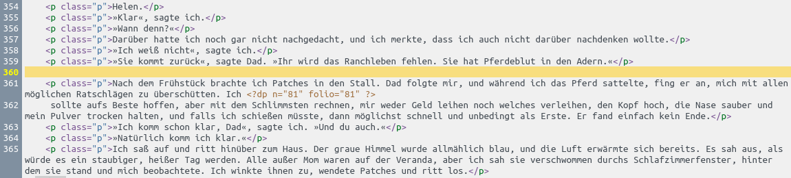

Target: Reduction of blank lines.
Name:	Edit Book (Target state).png
Questions
1) What do you think (with regard to copyright, ethics and such stuff, you know) of such an intervention?
2) HowToDo?
a) Remove all simple blank lines?
b) The extended blank lines (<p class = "p-blanc"> <br/> </ p>) are to be reduced to simple blank lines.
Regex-profs are particularly in demand here.

The blank lines in the source are not causing the extra space between lines in the displayed ebook.
Instead, this is a function of the CSS styling for paragraphs. Look for that.

Those have no effect on the output.
They exist solely for Readability by the Coder
IMHO 'Cheats' by the publisher of standard editions in using a general body-text line-spacing: greater than 1.2, is to make the book appear longer (use more screens).
Like any other generality, there are good reasons to use line-spacing: with bigger or smaller numbers. Those usually are restricted to a small portion, not the main body of the work.

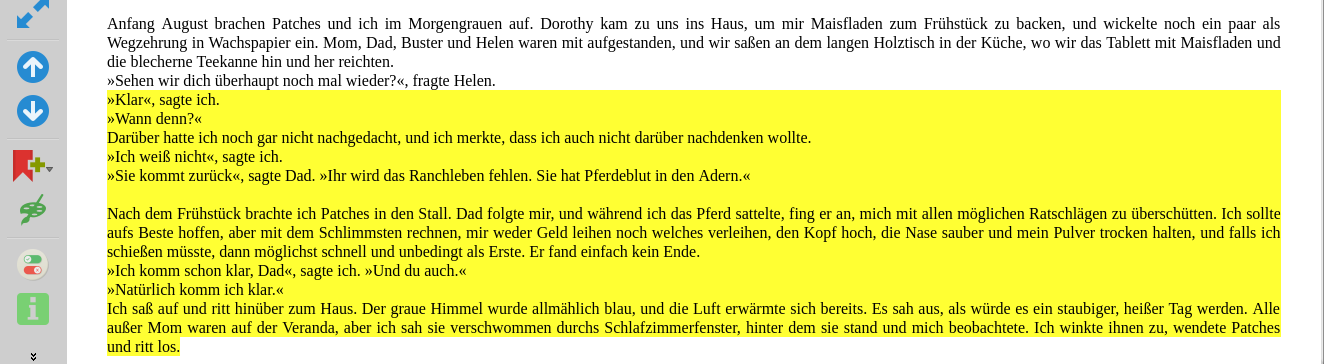

Yes, if you get shown, everything is easy. Sometimes at all possible.
For inspection of the complete stylesheet see here.
I just simplified the CSS properties margin-top and margin-bottom in some (selected) rows (63, 64 & 67, 68) to margin and set the value to zero. These seem me to be those that relate to the text.
The distinction between top and bottom seems me now superfluous.
Anyway, the result is at least OK.
Name:	Optimized lines.png
Book viewer (Optimized lines)
So I think the book is readable (by design). I'm still quite young.
Why did you set there a point in the code. Accidentally? I didn't.
p {margin:.0; text-indent: 0;
