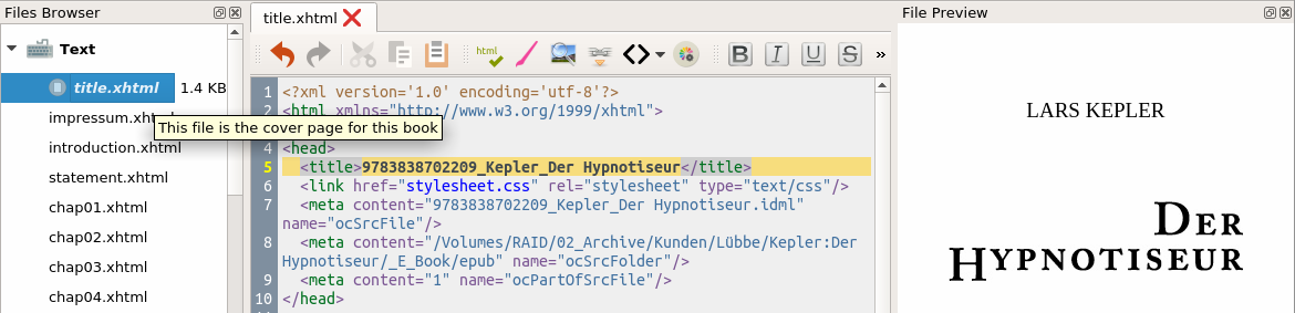

Book opens after remove bookmarks unexpectedly
Check Book:
INFO: The bookmarks file used by the calibre ebook viewer is present [META-INF/calibre_bookmarks.txt]
Description: This file stores the bookmarks and last opened information from the calibre ebook viewer. You can remove it if you do not need that information, or don't want to share it with other people you send this book to.
I Remove the file & Save
Now I expect the book opens with the cover page.
title.xhtml (This file is the cover page of this book)

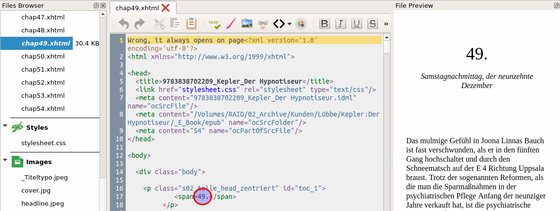

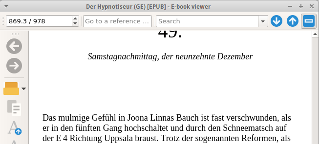

Thought wrong, it opens always (as I repeat the process multiple times) on chapter 49 (number half visible).
Edit Book view
chap49.xhtml

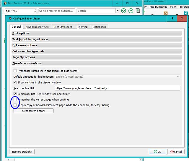

File ''iterator.pickle'' I can't open, the content is quite likely for me also of little interest.
... or set the option no to save them in the book.
You probably meant these two settings!?
Name:	Configure e-book viewer.png

Correct, those are the settings.
And iterator.pickle has a file extension which most text editors don't associate with plus it contains binary data, which is why you can't open it.
Nevertheless, if you delete it the bookmarks should be cleared away.

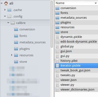

Okay, I made some experiments.
Name:	config_calibre (with iterator.pickle).png
.config_calibre (contains file iterator.pickle)
I delete that file.
Restart calibre and open various books, which read position I have noticed me.
With amazement: Exactly there the books reopen, not as expected at the beginning of the book.
File iterator.pickle is still missing in .config/calibre.
I change the reading position (as I continued to read ).
Another look in .config/calibre: Now the file iterator.pickle is established again.
Maybe I have something you've already told me overlooked. Otherwise your above thesis [...bookmarks should be cleared away.] is refuted.
__________________________________________________
I do not know what your example (unpickled) is or should show me.
Edit: Sorry, now I understand what it is: A fragment of that mysterous iterator.pickle file, of course!?

eschwartz
Ex-Helpdesk Junkie
eschwartz's Avatar
Posts: 19,421
Karma: 85400180
Join Date: Nov 2012
Well, I just tested it, and deleting iterator.pickle wipes away all bookmarks for me. Confirmed and thanks for encouraging me to field-test my theory.
But you do need to make sure it is not being saved inside calibre_bookmarks.txt
If either one is present, the bookmarks will still be there -- and they will get updated in both.
You can stop calibre from saving calibre_bookmarks.txt in the Viewer preferences
General ==> Miscellaneous options
Uncheck "Keep a copy of the bookmarks/current page inside the ebook file, for easy sharing"
Yes, my example was a fragment of iterator.pickle

Just to make sure, did you uncheck those two items (see image) in the viewer settings? If not, it will continue to open where you last closed.
If I have bookmarks I don't want/need, I just open 'show/hide bookmarks' in the viewer and delete them from there (I also delete in the file editor, but not sure if that's necessary, haven't tested that far).
Also, unless there's an option for it that I haven't seen, simply having a bookmark will not open the viewer at that location. Would be difficult when you have multiple bookmarks.
