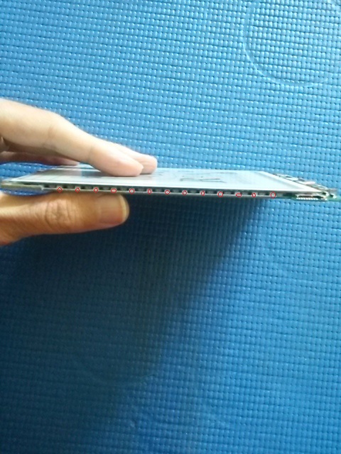

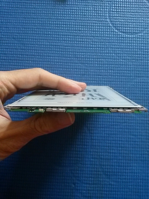

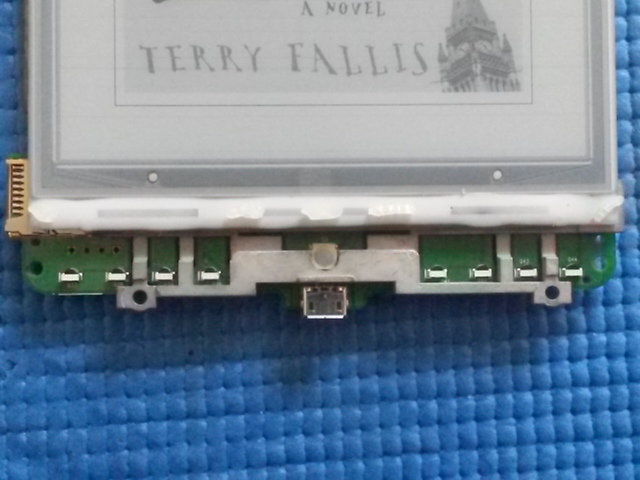

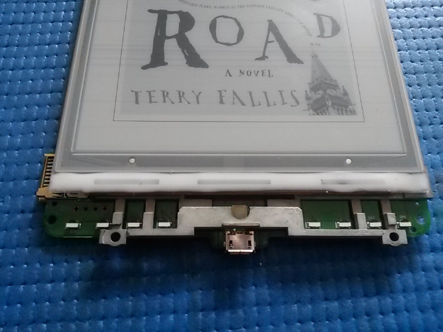

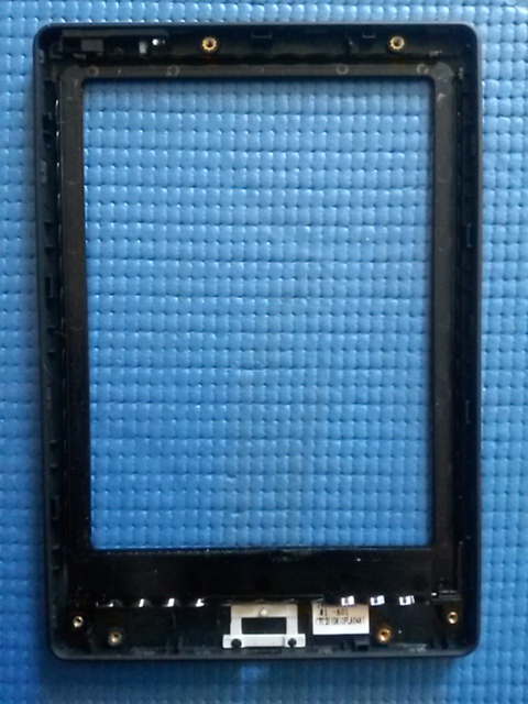

I'm working on a dead Kobo Touch as a guinea pig. I believe it's possible to have a rudimentary form of front-light. Here is my idea/project:
I don't want LED's to interfere with IR. I have attached all four sides of the Kobo. They are all occupied with sensors with distances, except for the area around home button which has a little nice spot to put 2-3 LEDs. On Kobo Mini, there's no home button, but hopefully this area is not occupied by IR sensors!???
The best spots to put LEDs:
A. Around home button
B. In the four corners
D. (maybe, just maybe but very unlikely - and a PITA) On right and left edge just between neighboring IR sensors
Top part is not good to put LEDs at all, except for two corners! So right, bottom and left edges of screen. In my opinion, only A and B are enough to have a nice front-light (maybe even just A suffices for a fair lighting!)
I have attached pictures and the LED spots I want to pursue (in red circles, you might need to zoom in to see).
What are your thoughts, people?

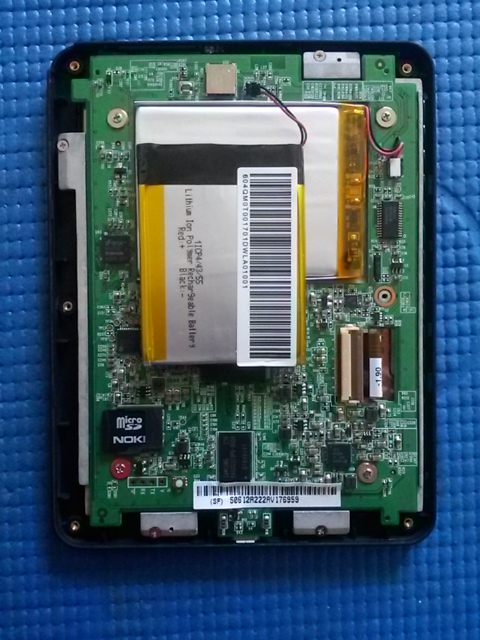

Old 10-23-2015, 04:10 PM   #9
thatworkshop
hub
thatworkshop ought to be getting tired of karma fortunes by now.thatworkshop ought to be getting tired of karma fortunes by now.thatworkshop ought to be getting tired of karma fortunes by now.thatworkshop ought to be getting tired of karma fortunes by now.thatworkshop ought to be getting tired of karma fortunes by now.thatworkshop ought to be getting tired of karma fortunes by now.thatworkshop ought to be getting tired of karma fortunes by now.thatworkshop ought to be getting tired of karma fortunes by now.thatworkshop ought to be getting tired of karma fortunes by now.thatworkshop ought to be getting tired of karma fortunes by now.thatworkshop ought to be getting tired of karma fortunes by now.
thatworkshop's Avatar
Posts: 715
Karma: 2151032
Join Date: Jan 2012
Location: Iranian in Canada
Device: K3G, DXG, Kobo mini

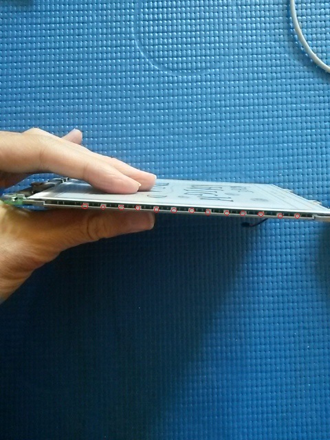

I am indeed very positive my plan will work.
I have put 5 rice grains to mimic size of LEDs on the bottom edge. I am delighted to say that the bezel sits quite nicely on the other edges and on the bottom edge looks very neat and tight enough to let light go through!
I will also salvage battery from the demise Kobo Touch and put in Mini to account for longer battery life in presence of LEDs in the system.

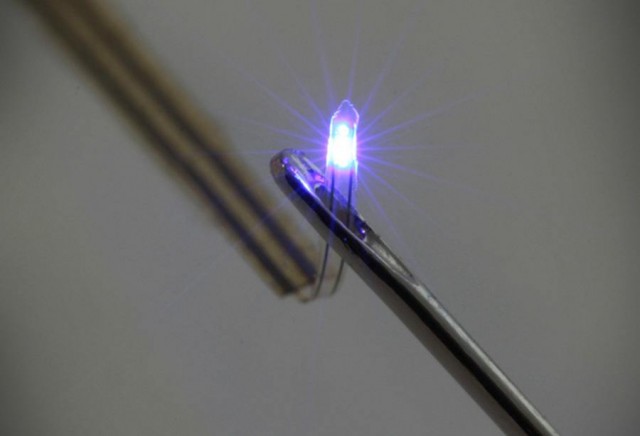

Well, the reason I shared this proof of concept is to get ideas from people who are experienced with electrical/electronical stuff.
I found some 1mm and 0.5mm LEDs that caught my eyes. Anyone please feel free to chime in.
Also, I'd like to first try it on my Kobo Touch to test and weed out interference between IR sensors and LEDs and get a sweet spot. The PCB board of my Kobo Touch is fried and if someone (in Canada/USA - North America) has one and is willing to donate for this small project, it'd be good.
I want to make this happen. Feel free to let me know your ideas and directions too. For LED, what about these: http://www.ebay.com/itm/161534532145
or even the simple attached LED that I have even on my bike's switch.
