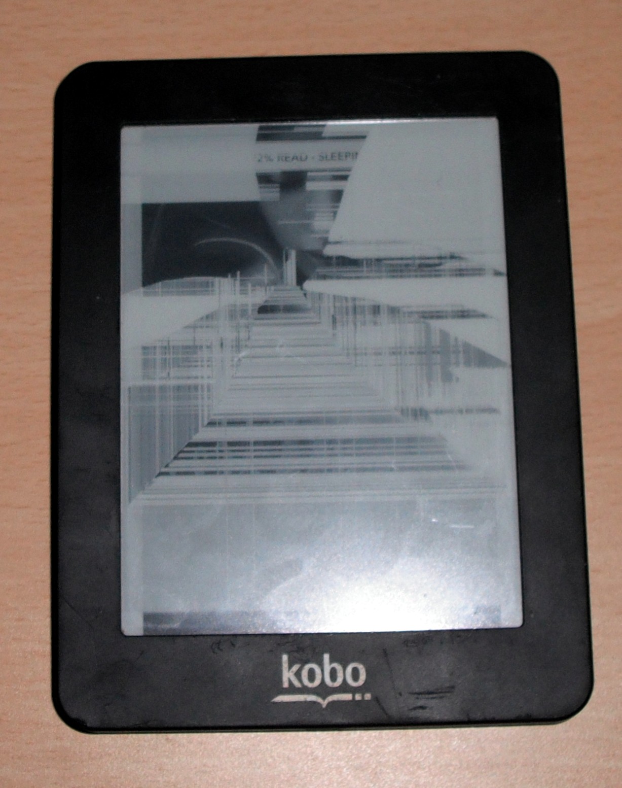

This device came to me as it is that’s why my answers are limited, I need to find the right firmware for it to see if it can be saved, when connected to pc connecting sound can be heard, there is sort of an image on the screen, it looks like a broken image that might indicate that the screen could be broken too.

Post picture of screen following fourm rules for max file size. Only then can we tell if is damaged. It would be thin glass behind eink screen layer that is cracked.

Yep, post a pic to confirm, but from your description I'd put money on the screen substrate being broken.

This is the photo of it.

Yes, it has a broken, substrate ! Classic look making easy to say definitely.

Looking at the bezel, it does look like user abuse.
The bezel on the Glo is easily marked, so I don't think it really user abuse. But, it does look like something hit the screen.

It's very obviously a smashed screen, which is why the FIRST thing I asked you was " What is showing on the screen at the moment?"?
If you'd answered that when I asked it, instead of sidestepping the question repeatedly, we could have all saved ourselves some trouble.
If you paid for it, I suggest asking for your money back.
