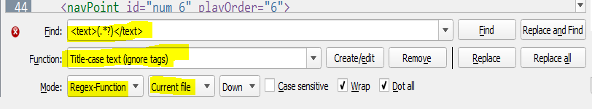

Use search/replace
I think you can accomplish this with the search/replace function. First select the toc.ncx file, then use the following settings in search/replace.

If the image didn't work, then use these settings in the search/replace panel.
Find: <text>(.*?)</text>
Function: Title-case text (ignore tags) [select this from the drop arrow]
Mode: Regex-Function --- Current File
That should change all of the labels in your TOC to Title-case.

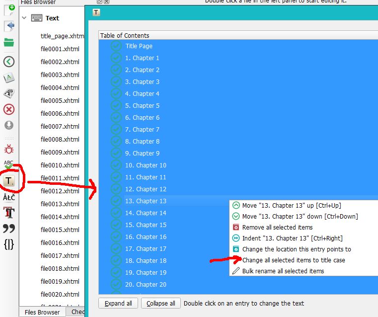

Or you can choose Edit TOC, do select all (ctrl+A), then right click, and choose 'Change all selected items to title case'. I have the Edit TOC button on my toolbar, but otherwise it would be in the Tools menu. See image, although that is a bad example that doesn't need to change, but it will give you an idea...
If only a few need to be changed, then just right click on each on as needed to change. Hope this helps!
Ooops, I re-read your post, and then went to retest it. It always used to work, so that must be a bug. The last few months, I've taken to changing the titles in the actual document to be title case and the rebuilding the TOC, but I used to always right click in the TOC and change it that way.

Using the search/replace method you can choose from various functions to accomplish (Upper/Lower/Swap/Title/Capitalize). Calibre has these option built into the regex-function section.

  • If the entries are all caps (eg. TABLE OF CONTENTS TEST), then it works.
  • If the entries are like the example given (eg. Chapter 12 - TABLE OF CONTENTS TEST), then it doesn't work.
  • If 'Chapter' is also in caps (eg. CHAPTER 12 - TABLE OF CONTENTS TEST), it works.
Not sure if that's wanted behavior or a bug or oversight.
