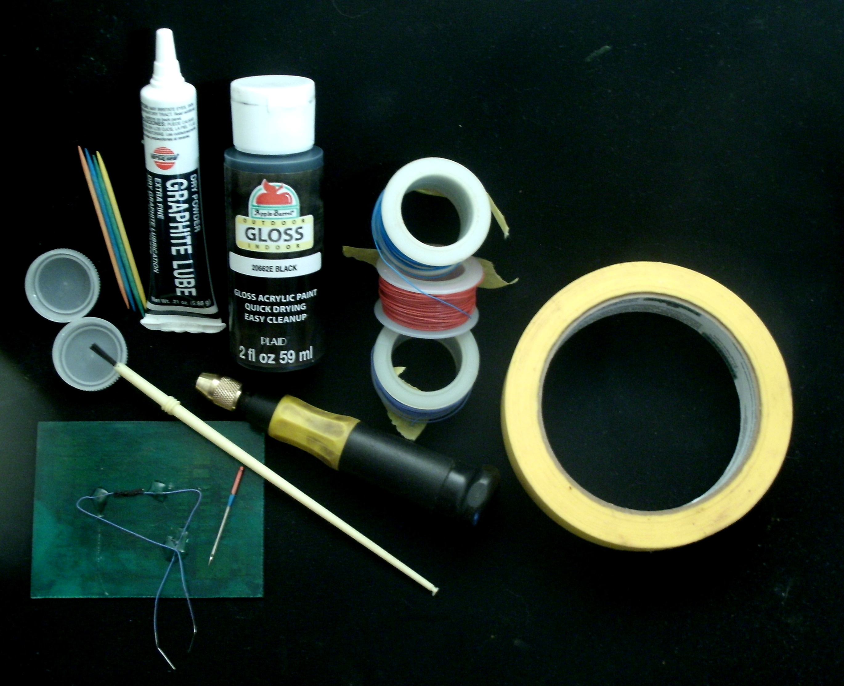

  • Photo #1 - the "paint and play" kit.
    This will be a DIY conductive ink type of connection.
    There are many sources of (usually expensive) conductive ink, but my intended audience only needs three or four drops of it.
    And they probably don't have any use for the left-over ink.
    So here we will make our own.
    • DIY conductive ink
      • Extra fine graphite - such as for locks - auto supply, hardware store, etc.
      • Gloss Black Acrylic Paint.
        Note: The recommendation I read was for Black Acrylic INK, but my local hobby-crafts and artist supply store was sold-out.
        So here's hoping the black pigment in acrylic paint is as conductive as the blank pigment in acrylic ink.
    • Mix and apply tools
      • Small plastic mixing containers (bottle caps here).
      • Mixing tools (toothpicks)
      • Smallest Artist's paint brush you can find.
    • Serial port wire and materials
      • 30 gage, insulated, wire-wrap wire. Any insulated, 28 ... 32 gage wire will do.
      • Low residue tape - I.E: "Painter's tape"
      • Pin vise - as a handle for the forming tool (optional)
      • Forming tool - sewing machine needle (a regular needle would do)
    • Our test jig
      This is the goal of this first post, make the ink, apply it between two wires, measure its conductivity to see if our DIY ink will serve our purpose.

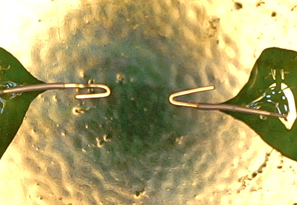

  • Photo #2
    The Kindle motherboard is fiberglass PCB covered with a solder mask.
    The test jig is a PCB covered with a solder mask. The point is to check materials compatibility as we build our painted connection.
    Also one stripped end of the wires we will be using.

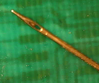

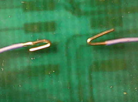

  • Photo #3
    We need to bend a small hairpin loop in the ends of our wires.
    The wire used, and shown in the prior photo, is 0.010 inch (0.255 mm) in diameter. So having a tool to bend it with is nice.
    This is a sewing machine needle, because the shank is large enough for even human sized fingers to hold and roll.

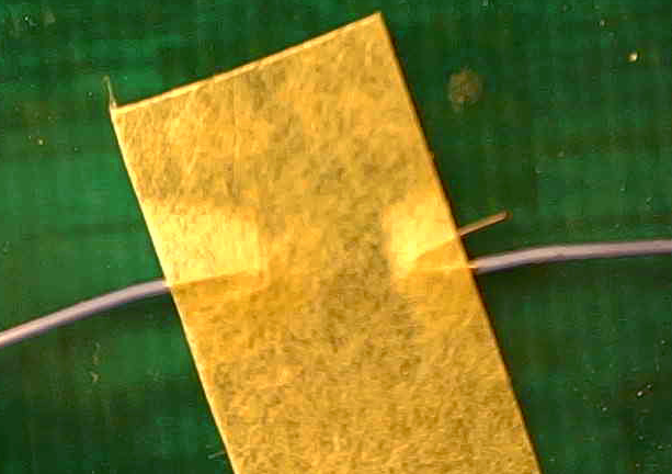

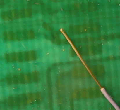

  • Photo #4
    One of the wire leads with a (sort-of) nice hairpin loop in the end.
    You can see the "bump" left from my first try to bend it, and then straighten it out again.
    The scale of things we are working with is the reason for the "forming tool".
    Just doing this with your fingers is possible, but can be tedious.

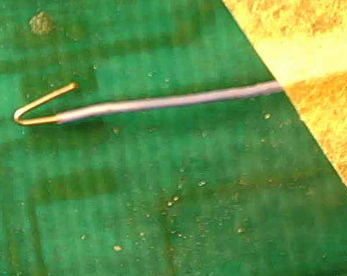

  • Photo #5
    The second wire, with a sloppy hairpin hook formed, held in place with some "temporary" type of tape.
    Well back from the end.
    You will notice that the hairpin hook does not want to lay flat on the board. We will take care of that RSN.

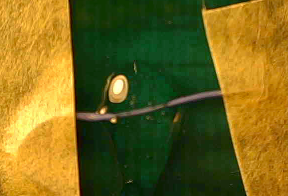

  • Photo #6
    The two hairpin hooked ends of the wires, positioned and held in-place by the "temporary" tape off-screen to the right and left.
    Note that the hooks are not (yet) flat to the board.

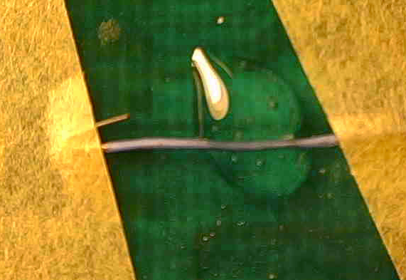

  • Photo # 10
    After gently removing the "temporary" tape, gently I say, so as not to pull the hook ends of the wires away from the board, you can see the wires now positioned and held in-place.
    Notice that the wires are close enough to the board that the Epoxy "wicked" along the wires.
    Sorry about the funky lighting.

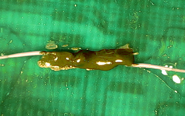

  • Photo #11
    Using that tiny paint brush, span the two ends of the wires with a line of the DIY conductive paint.
    The brand shown in the kit picture can be "cleaned up" (corrected) with water before it dries.
    Allow to dry (the brand shown claims 1 hour).
Alright - the bottom line - did we make a painted-on, resistor?
Yes - this one measures 790 ohms.
