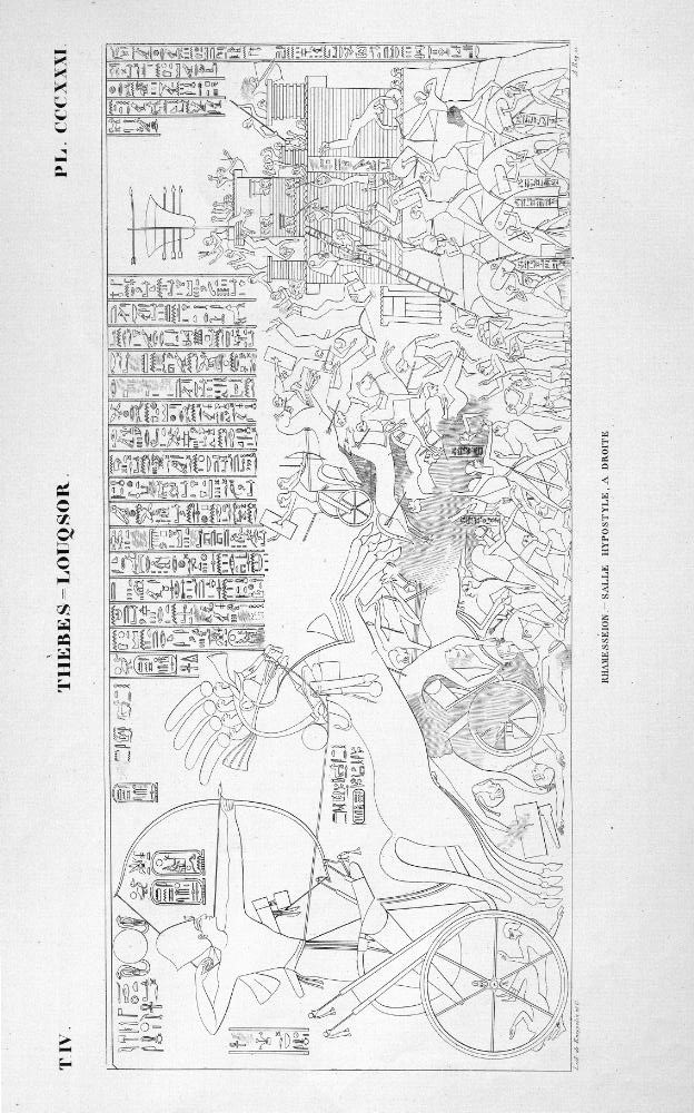

They're not the world's greatest quality scans. I've attached one so you can see what they're like (they're reproductions of carvings on Egyptian monuments). I'll try the various processing options in Calibre and see what the results are; my aim is to make the hieroglyphic inscriptions are clear as possible, so I can work on translating them. There are really too many to do by hand.

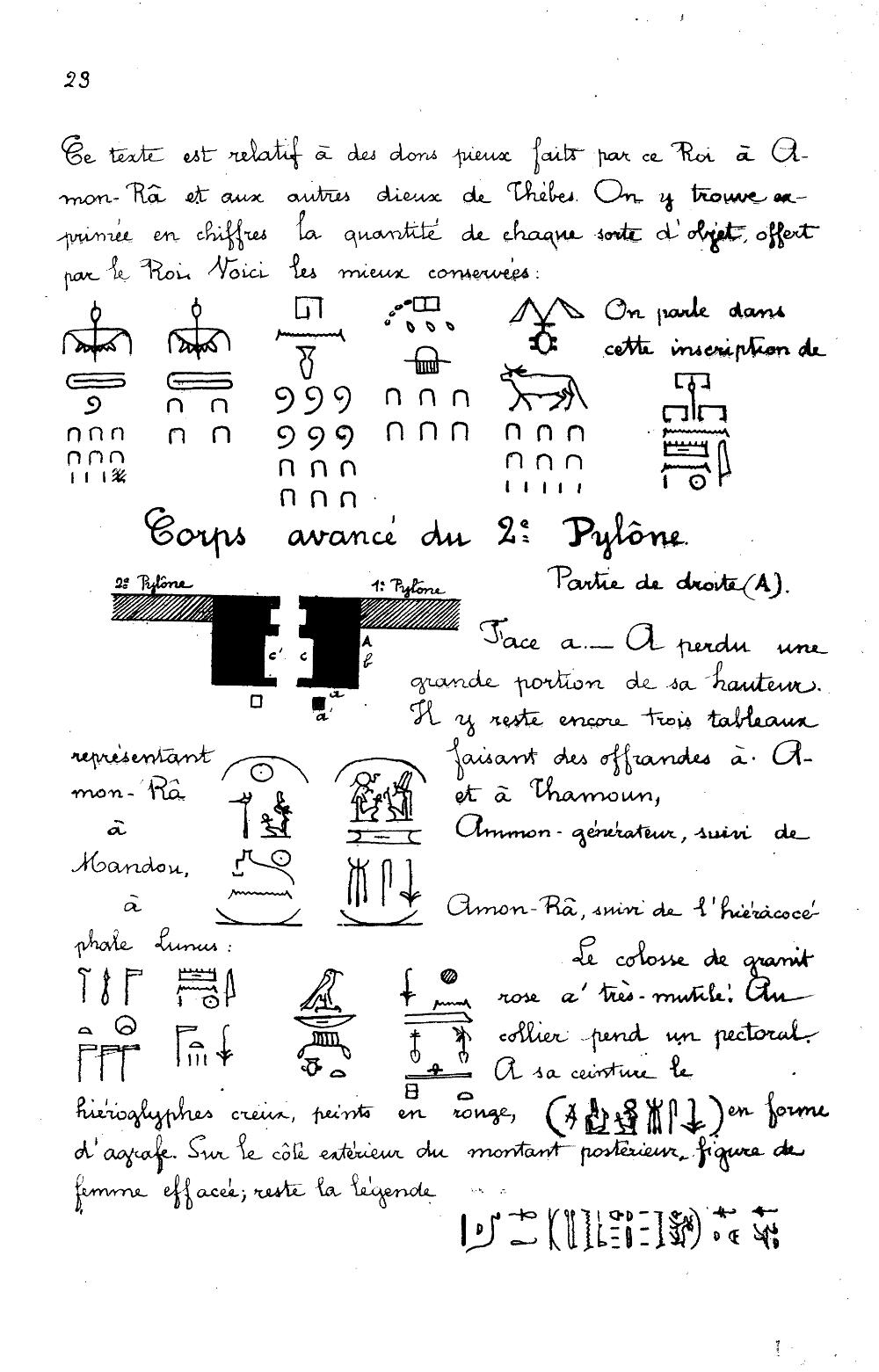

Does anyone have any tips for ways to shrink the size of the PDF? They are page scans, and completely unsuited for OCR. It's a hand-written book - basically the diary of an expedition to Egypt in the 1820s - and every page has little sketches of buildings, hieroglyphic inscriptions, etc, on it. I've attached one of the page scans to shows what a typical page looks like. As you can see, there's absolutely no way it could sensibly be OCR'd!. Can anyone think of a way to reduce the size of the PDF?
