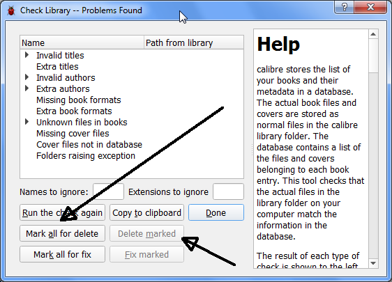

Location: Notts, England
What do you want to do?
Your original post implies you want to delete them. If so, then why not press the "Mark all for delete" button then "Delete marked"?

millan is offline   Reply With Quote
