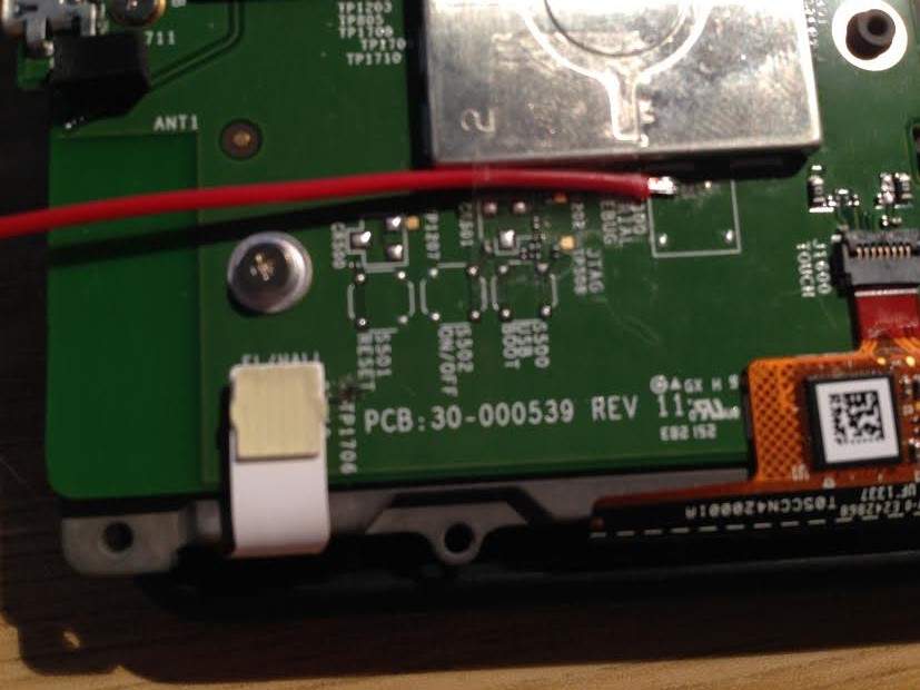

The soldering was really not easy. It's not a great picture but both the RX and 1.8V points are damaged. Is there any other way or is this it?
