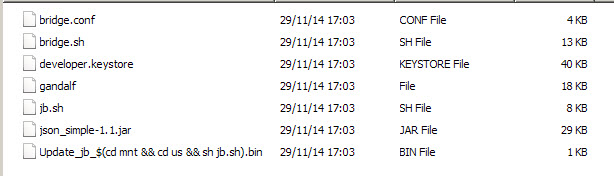

Jailbreak file list
File list attached
I should have added that my Kindle firmware version is 5.3.7.2. Serial no starts B011, which I believe makes it a K5.

I'll try to upload an image of the file list I copied in case I've got the wrong jailbreak.
Any ideas?
Thanks, Stephen
Nothing in the list of events you report checks to see if the jailbreak was actually installed and working.
Add a step 3.5 to test if jailbreak is present and working.
Attempting to install one of our *.bin packages should be enough, if correct package for your model Kindle, the "Update Your Kindle" button will not be grayed out.
Note: The file list above **must** have been made before you attempted to jailbreak your Kindle - because the process would have consumed the update_*.bin file.

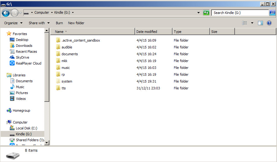

The message **** JAILBREAK **** did appear on the screen after installing the jailbreak. I restarted it (I do mean restarted) straight afterwards and it was immediately then that I could no longer download from Amazon.
Yes, the copied files were all consumed - that was a snapshot of the files after copying them to the Kindle. I attach a snapshot of the root after running the jailbreak.
I copied the Dummy Test Hack 'Update_dummy_0.0.N.bin' to the root. 'Update your Kindle' was available on the Settings menu. I updated the Kindle, the Update Successful message appeared and the Kindle restarted. It then stuck at the front page with the tree. I waited five minutes with nothing happening and then did a restart by holding the power button for 40 seconds, which brought the Kindle back to my home page OK.
Have I done everything correctly?
