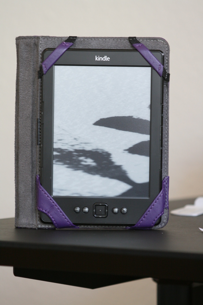

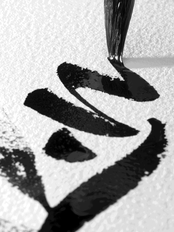

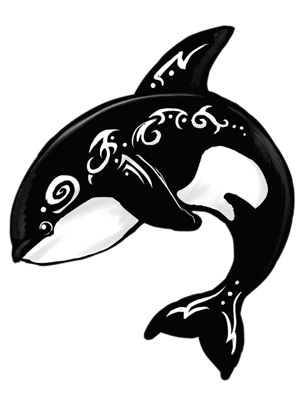

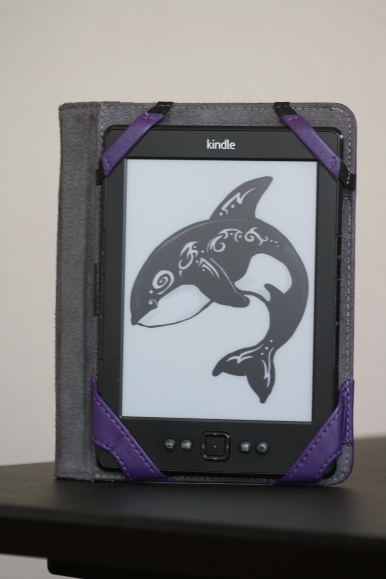

Hi everyone,
This is my first post here, but I've used the forum extensively so thank you for providing such a great resource!
I have a jailbroken Kindle 4 NT with USBNet installed. Everything works as expected except for one thing I can't figure out. I haven't been able to find the same problem on these forums.
I am using the Kindle to display 8bit PNG images at regular intervals using eips. To display an image I do:
The problem is that some images display correctly while others, for lack of a better word, get kind of 'skewed'/distorted. Even the Kindle's default screensaver images.
I've attached two images, one that works and one that doesn't. Attached is also pictures of how they look on the Kindle.
I hope someone has an idea why this happens. Thanks in advance!

They need to be saved as true PNG-8, even if they're dithered down to 16 colors.
The first one is, the second isn't, it's saved as a paletted PNG, which eips can't deal with.
Orca.png PNG 600x800 600x800+0+0 8-bit sRGB 256c 29.9KB 0.000u 0:00.000
scr.png PNG 600x800 600x800+0+0 8-bit sRGB 16c 94.5KB 0.000u 0:00.000
Orca.png: PNG image data, 600 x 800, 8-bit grayscale, non-interlaced
scr.png:  PNG image data, 600 x 800, 8-bit colormap, non-interlaced
