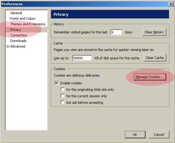

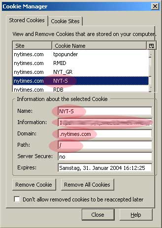

3) Now go to Menu:Tools:Preferences and from there go to the Privacy tab. Open the cookie manager. See all the cookies whose "site" is "nytimes.com":
nytimes.com spopunder
nytimes.com tpopunder
nytimes.com RMID
nytimes.com NYT_GR
nytimes.com NYT-S
nytimes.com RDB
nytimes.com nvt-d
Keep the cookie manager open for a while. We will need it later in step 4.

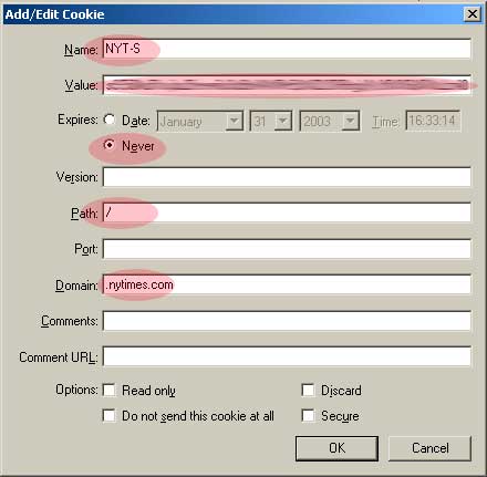

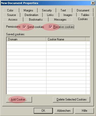

4. So you want to add the two cookies to iSiloX. Open iSiloX, create a new channel and go to the cookies tab. Make sure you check both permissions, send cookie and receive cookie. Then click on "Add Cookie..." With the Phoenix Cookie Manager still open, go to the first required cookie, nytimes.com NYT-S. Copy the information there to your iSiloX Cookie entries (field "information" in Phoenix corresponds to field "value" in iSiloX). Do the same thing for the second require cookie, nytimes.com RMID. See attached screendumps for examples.

Screendump 1:

Screendump 2:

Screendump 3:

Screendump 4:
