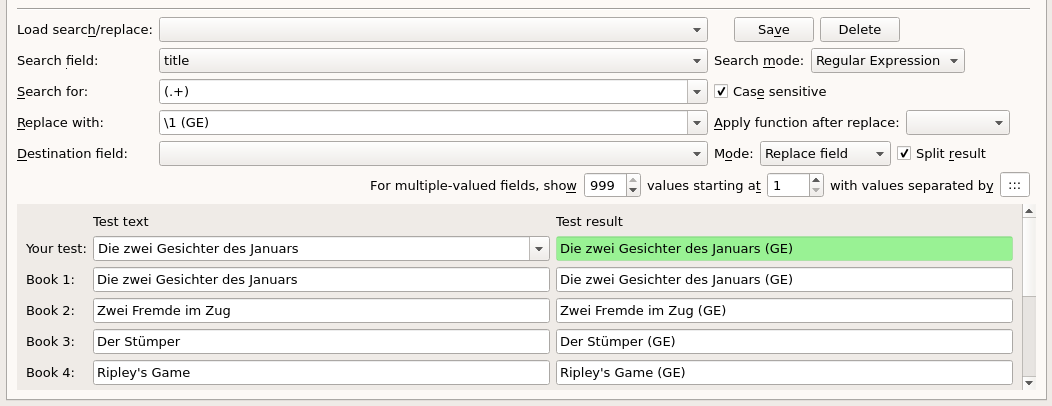

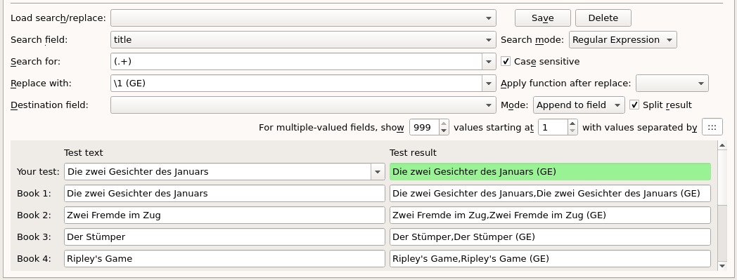

The book Die zwei Gesichter des Januars show different results in the column Test result depanding of it is in line Your test or Book 1.
Name:	Edit meta information.png
It's my first time with regexes in action so allow me to consult you again.
I see that the test result is okay! The rest also?
Search field: title - otherwise nothing happens.

No, it's not OK. Don't use "Append to field" but "Replace field" in the Mode selection.

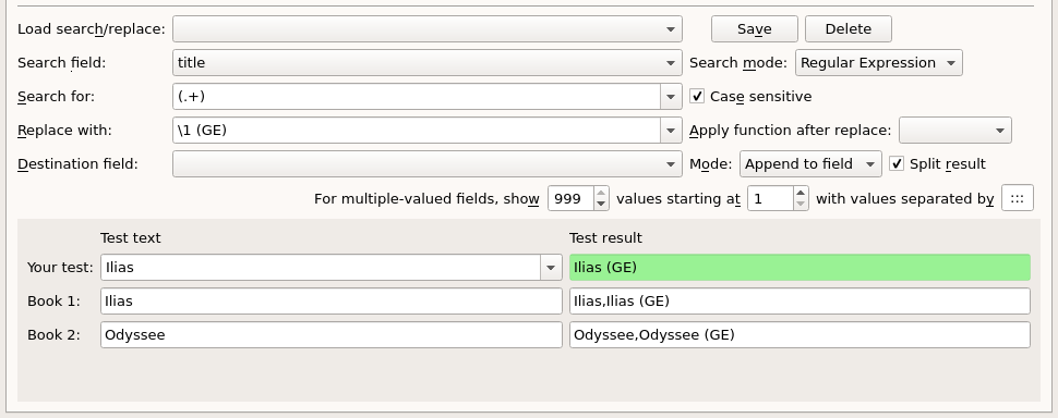

Name:	1 (GE) & Append to field.png
(.+) + \1 (GE) + Append to field
Acurate Test results is what you want. No unintended side effects showing
I don't know what are unintended side effects. If the final (processed) result is wrong any u.s.effects are unimportant.

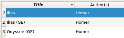

In my library there are books of different original languages but mostly translated to German. To see at first glance that a book with a German title isn't a originally in German written book I add (GE).
Let me present the advantages.
Name:	Ilias in 2 languages.png
It shows at a glance the Ilias in original language (without adjunct) and a translated version: Ilias (GE)

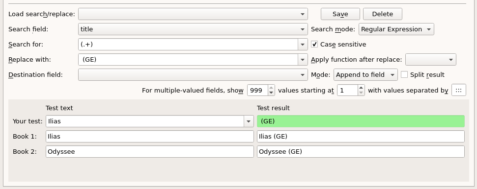

If he only wanted to add a suffix, with Append Mode he would need (.+) => (GE) (Without \1). In the other way, he gets two titles (as it's shown in the picture).
Partly you are right. But see
Name:	(.+) & (GE) & Append to field.png
(.+) + (GE) + Append to field
There are (unwanted) commas in the Books -> Test results. Take also attention to the Your test result, a single (GE).

@chaot, if you look at you picture, you'll see that you have a check near the "Append result", "Split result". If you uncheck it, the comma go away. If you play a bit with the fields you will be able to obtain your desired result.
Old 03-20-2015, 04:21 PM   #13
chaot
Head of lunatic asylum
chaot will give the Devil his due.chaot will give the Devil his due.chaot will give the Devil his due.chaot will give the Devil his due.chaot will give the Devil his due.chaot will give the Devil his due.chaot will give the Devil his due.chaot will give the Devil his due.chaot will give the Devil his due.chaot will give the Devil his due.chaot will give the Devil his due.
chaot's Avatar
Posts: 349
Karma: 77620
Join Date: Jun 2012
Location: UTC +1
Device: Tolino Vision 3HD
Really fast. And correct!
In the Replace with field is to insert an space before (GE).
Even I can only reflect on your posts or play a bit with the fields - both is impossible
Name:	(.+) +  (GE) + Append to field + Split result uncrossed.png
The processing was OK.
Now we got 2 versions to result same!
(.+)|(GE)|Replace field|Split result crossed
(.+)| (GE)|Append to field|Split result uncrossed
Still the Your test line is a mystery to me.
