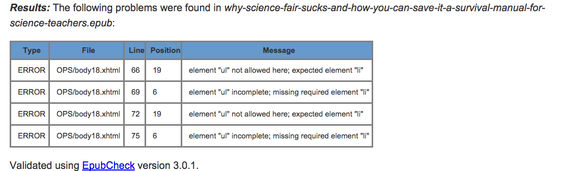

Hello,
I'm attempting to publish my book on Smashwords and have run into validation errors. I got the attached message through validator.idpf.org/
How do I find and fix this error? I created the ePub using Scrivener, if that helps.
Thanks a ton.
-Adam
Name:	Screen Shot 2015-02-20 at 3.18.16 PM.png

Originally Posted by ashopis View Post
Hello,
Thanks a ton.
-Adam
Could you give us the XHTML of lines 66-69 and 72-75 please? I know nothing about Scrivener, but my best guess is that you have <ul> ... </li> in both places. If I remember rightly <ul>...</ul> is not allowed in ePub2 anyway.
AFAIK, EPUB 2 supports all xhtml 1.1 tags, including <ul>.

The tag is fully supported of course. It is just to indicate that it is an unordered list after all. Correct syntax would be something like this:
<ul>
<li>first list item</li>
<li>second list item</li>
<li>third list item</li>
</ul>
As you can see, the list items must be enclosed in the <ul></ul> tags. Also, don't forget to close the list items. I know that HTML gets away with it, as the renderers close it for you, but XHTML is more strict.

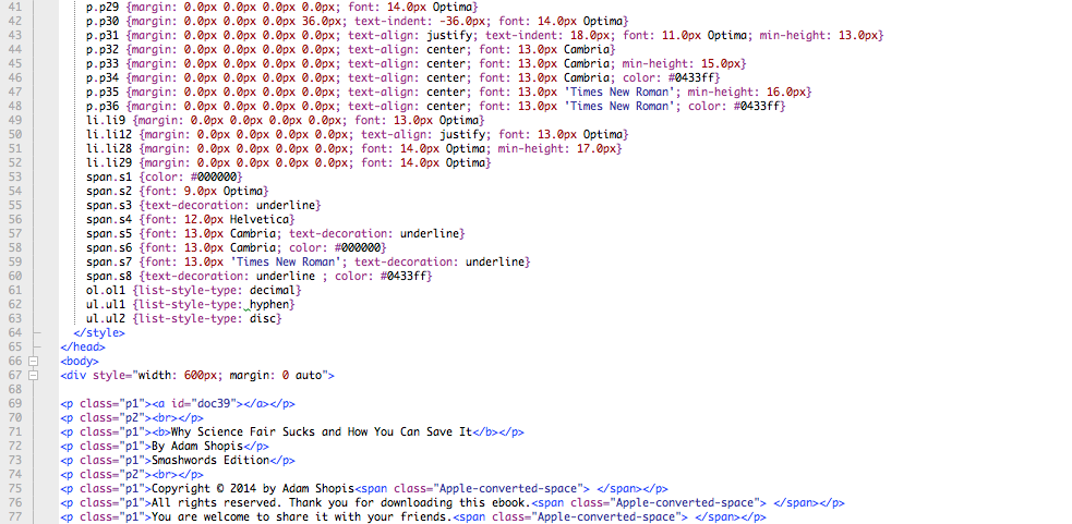

Here are the first couple hundred lines of the html. I'm not sure I converted it correctly from Scrivener and it's pretty much gobledy-gook to me.
Any help would be awesome!
-Adam
P.S. I can't upload the html document as an attachment so I copied and pasted it below. I've also taken a screenshot of the only portion of the file that seems to contain "li" and "ul" tags. They are at lines 49-52 and 61-63.

Name:	Screen Shot 2015-02-21 at 7.26.51 AM.png

Is this output from Scrivener? It is awful! Isn't there a possibility to export to ePUB with an external stylesheet? This is unmaintainable.
There are multiple things wrong with this file. It is generated by Cocoa HTML Writer it seems, but XHTML is not the same as HTML. There are differences and that is what is causing the errors here. There are issues with the meta tags and also in the text with things like <br> instead of <br />. In XHTML all tags must be closed, either with an end tag or auto close for tags that do not have an end tag, like br, img, hr and others.
What is your exact work procedure, because this is not a valid ePUB in any way.

It looks like the author did not use styles in the source. GIGO The word processor is being used like a typewriter.
Dale

You can fix a multitude of HTML sins with:
xmllint --html inputfilename.html --xmlout > outputfilename.xhtml
YMMV, of course.

Well, very early on I see this line in the style sheet:
p.p1 {margin: 0.0px 0.0px 0.0px 0.0px; text-align: center; text-indent: 18.0px; font: 14.0px Cochin}
I think it's a bad idea to use absolute dimensions in an e-book, and a very bad idea to specify the size and fact of the font. Were you planning to embed Cochin? Not all e-book readers support embedded fonts, and of those that do, many owners of them prefer to specify their own choice of font.
I too would like to know how this file was built. Scrivener is supposed to be a book-writing program as well as a book-formatting program. Did you use the program's built-in styling / formatting tools?

It looks suspiciously like the output from TextEdit's RTF to HTML code. At a minimum, yes, you need to replace pixels with em units. Ordinarily, I would suggest combining rules and specifying multiple rules on paragraphs as needed, except that if you're producing for Kindle, that's likely to break things badly, so....
Anyway, here's a quick first pass at changing px sizes to em sizes.
<style type="text/css">
p.p1 {margin: 0 0 0 0; text-align: center; text-indent: 1.125em; font: 0.875em Cochin}
p.p2 {margin: 0 0 0 0; text-align: center; text-indent: 1.125em; font: 0.875em Cochin; min-height: 1.063em}
p.p3 {margin: 0 0 0 0; text-indent: 1.125em; font: 0.875em Cochin; min-height: 1.063em}
p.p4 {margin: 0 0 0 0; text-indent: 1.125em; font: 0.875em Cochin}
p.p5 {margin: 0 0 .75em 0; text-align: center; font: 0.938em Optima}
p.p6 {margin: 0 0 0 0; text-align: center; text-indent: 1.125em; font: 0.875em Optima; min-height: 1.063em}
p.p7 {margin: 0 0 0 0; text-align: center; text-indent: 1.125em; font: 0.875em Optima}
p.p8 {margin: 0 0 0 0; text-indent: 1.125em; font: 0.813em Optima; min-height: 0.938em}
p.p9 {margin: 0 0 0 0; font: 0.813em Optima}
p.p10 {margin: 0 0 0 0; text-indent: 1.125em; font: 0.813em Optima}
p.p11 {margin: 0 0 0 0; text-align: justify; font: 0.813em Optima; min-height: 0.938em}
p.p12 {margin: 0 0 0 0; text-align: justify; font: 0.813em Optima}
p.p13 {margin: 0 0 0 0; text-align: justify; text-indent: 1.125em; font: 0.813em Optima; min-height: 0.938em}
p.p14 {margin: 0 0 0 0; text-align: justify; text-indent: 1.125em; font: 0.813em Optima}
p.p15 {margin: 0 0 0 0; text-indent: 1.125em; font: .688em Optima}
p.p16 {margin: 0 0 0 0; text-align: justify; font: 0.813em Optima; color: #323333}
p.p17 {margin: 0 0 0 0; text-align: center; text-indent: 1.125em; font: 0.813em Optima}
p.p18 {margin: 0 0 0 2.572em; text-indent: -2.572em; font: 0.813em Optima}
p.p19 {margin: 0 0 0 0; text-align: center; font: 0.813em Optima}
p.p20 {margin: 0 0 0 0; font: 0.813em Optima; min-height: 0.938em}
p.p21 {margin: 0 0 0 0; text-align: justify; font: 0.875em Cochin; min-height: 1.063em}
p.p22 {margin: 0 0 0 0}
p.p23 {margin: 0 0 0 1.125em; font: 0.813em Optima}
p.p24 {margin: 0 0 0 1.125em; font: 0.813em Optima; min-height: 0.938em}
p.p25 {margin: 0 0 0 0; text-align: center; font: 0.813em Optima; min-height: 0.938em}
p.p26 {margin: 0 0 0 2.572em; text-align: justify; text-indent: -2.572em; font: 0.813em Optima}
p.p27 {margin: 0 0 0 0; text-align: center; font: 0.875em Optima}
p.p28 {margin: 0 0 0 0; font: 0.875em Optima; min-height: 1.063em}
p.p29 {margin: 0 0 0 0; font: 0.875em Optima}
p.p30 {margin: 0 0 0 2.572em; text-indent: -2.572em; font: 0.875em Optima}
p.p31 {margin: 0 0 0 0; text-align: justify; text-indent: 1.125em; font: .688em Optima; min-height: 0.813em}
p.p32 {margin: 0 0 0 0; text-align: center; font: 0.813em Cambria}
p.p33 {margin: 0 0 0 0; text-align: center; font: 0.813em Cambria; min-height: 0.938em}
p.p34 {margin: 0 0 0 0; text-align: center; font: 0.813em Cambria; color: #0433ff}
p.p35 {margin: 0 0 0 0; text-align: center; font: 0.813em 'Times New Roman'; min-height: 1em}
p.p36 {margin: 0 0 0 0; text-align: center; font: 0.813em 'Times New Roman'; color: #0433ff}
li.li9 {margin: 0 0 0 0; font: 0.813em Optima}
li.li12 {margin: 0 0 0 0; text-align: justify; font: 0.813em Optima}
li.li28 {margin: 0 0 0 0; font: 0.875em Optima; min-height: 1.063em}
li.li29 {margin: 0 0 0 0; font: 0.875em Optima}
span.s1 {color: #000000}
span.s2 {font: .563em Optima}
span.s3 {text-decoration: underline}
span.s4 {font: .75em Helvetica}
span.s5 {font: 0.813em Cambria; text-decoration: underline}
span.s6 {font: 0.813em Cambria; color: #000000}
span.s7 {font: 0.813em 'Times New Roman'; text-decoration: underline}
span.s8 {text-decoration: underline ; color: #0433ff}
ol.ol1 {list-style-type: decimal}
ul.ul1 {list-style-type: hyphen}
ul.ul2 {list-style-type: disc}
</style>
